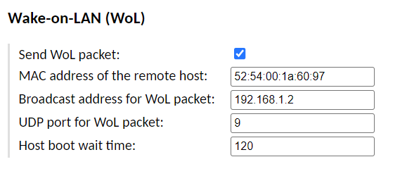

Hello,can you please help me to make wake on lan working for my apache instance?

I don’t use WOL so I’m not sure how I could help. There may be someone else here that can.
Unlucky me :(
Maybe anyone who is using wake on lan can help me? I want to make one VM for my mom to use :(
just enable it and enter the values, for a VM you need to enable WOL for VM's (plugin), address is then unraid, boot wait time depends on if hw passthrough etc ... or VM sleep ...
working oob here
working oob here
Thanks, that worked. I don't know why i put 255 255 255 255 for broadcast address :( When changed to ip everything started to work, this is pefrect
