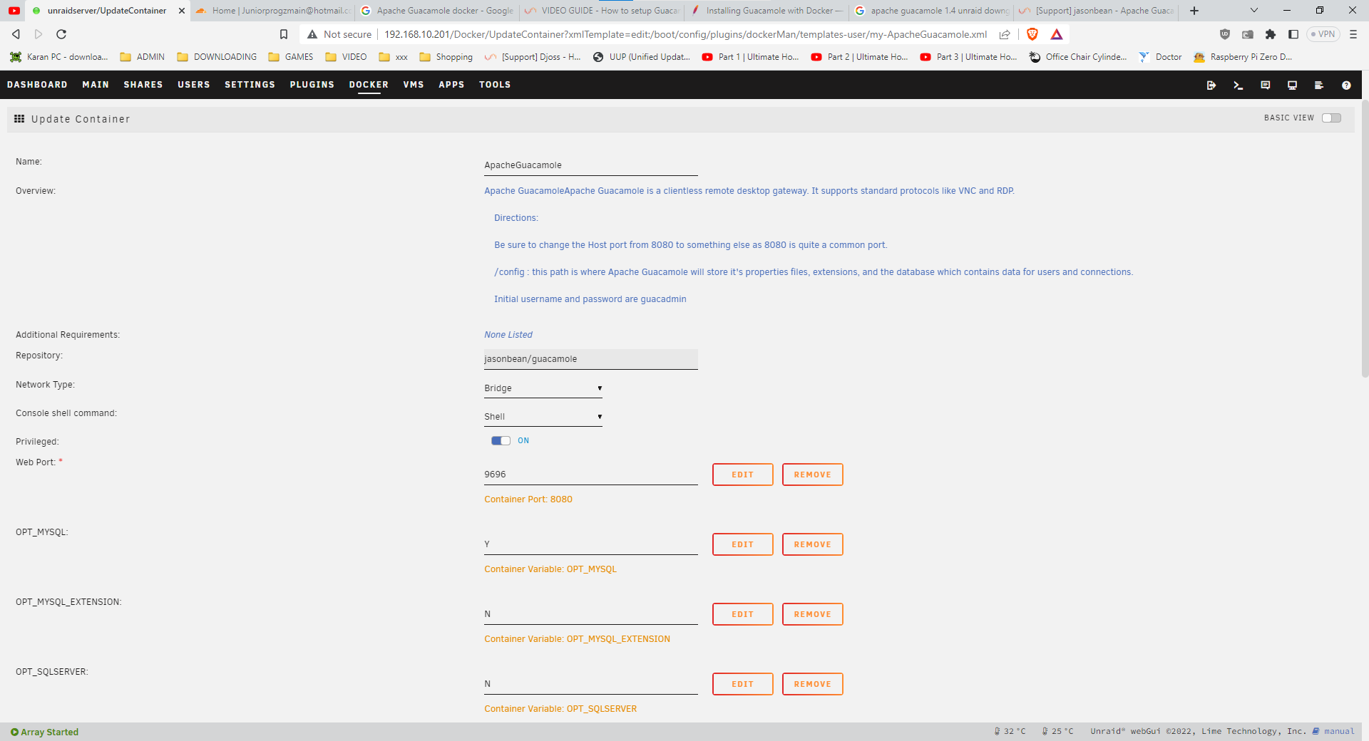

Hello,
I don't use mariadb and upgraded the docker and have this in the log
User UID: 99
User GID: 100
Using existing properties file.
Using existing MySQL extension.
Using existing TOTP extension.
No permissions changes needed.
Database exists.
Database upgrade not needed.

Any idea how to fix?
Any idea how to downgrade to a previous repository ?

@bombz You say you're not using MariaDB but you obviously have OPT_MYSQL set to "Y" in your configuration because it would not attempt to install the MySQL extension otherwise. MariaDB is essentially equivalent to and a drop-in replacement for MySQL. What I would recommend is downgrading to the 1.4.0-3 release and then upgrade back to latest.

I did note the red banner in the thread... is there a detailed guide on how to perform this db upgrade for this container?
Thank you.
Thank you for the fast response, and do apologize if I missed something.
Now that I am back on 1.4.0-3 what is the step process to upgrade the db and container successfully?
Do I have to change:
OPT_MYSQL: from Y to N ?
Edited by bombz
Now that I am back on 1.4.0-3 what is the step process to upgrade the db successfully?
If you’re not using the included MariaDB/MySQL then what are you using to store the Guacamole data? Do you have the MySQL settings in your guacamole.config file commented out?
18 minutes ago, bombz said:
Hello again,
I will attempt to be as detailed as possible to give you insight to assist with this concern.
I previously used mariadb a long time ago.
I then since migrated over to MySQL docker (stopping and removing mariadb) but did take a backup of the mariadb docker folder for archive purposes.
Since the migration to MySQL months ago, apacheguac was not affected in that migration and continued to be operational (migrated mariadb to MySQL for my nextcloud docker instance).
Today I was checking my docker instances, which I noted some updates were available. I generally always check my dockers are accessible via my revproxy (which they were) today.
I then decided to update the guac docker, to which led me here to the thread to see any posts related to the error.
MySQL db docker instance 'repository: mysql'  does not have any physical db listed or indicated to apacheguac.
Currently downgrading my apacheguac instance, it is back and operational, w/o meriadb docker deployed at all (not in my set of dockers)
So I am questioning (or clearly not understanding) the link between MySQL or mariadb and the guac docker.
Does guac have it's own SQL db embedded within the docker itself?
Looking for a solution to process the apacheguac upgrade process correctly.
Hope that helps :-)
I think I get it now.
I must have been on an older version of ApacheGuacamole
I pushed the update today using jasonbean/guacamole
Which I then had the errors described above
I then was able to downgrade to jasonbean/guacamole:1.4.0-3
Which was then operational
I then edited the repository to jasonbean/guacamole
Which now shows the deamon started on version 1.5.0
User UID: 99
User GID: 100
Upgrading MySQL extension.
Upgrading TOTP extension.
Updating user permissions.
Database exists.
2023-04-01 17:24:59,749 INFO Included extra file "/etc/supervisor/conf.d/supervisord.conf" during parsing
2023-04-01 17:24:59,750 INFO Set uid to user 0 succeeded
2023-04-01 17:24:59,755 INFO supervisord started with pid 33
2023-04-01 17:25:00,761 INFO spawned: 'guacd' with pid 34
2023-04-01 17:25:00,764 INFO spawned: 'mariadb' with pid 35
2023-04-01 17:25:00,768 INFO spawned: 'tomcat' with pid 36
guacd[34]: INFO:        Guacamole proxy daemon (guacd) version 1.5.0 started
I think I am good to go now.
Apologies for misunderstanding this. From what I can tell I was on a version previous to 1.4.0-3 and upgraded to 1.5.0.
Make sense?
Thank you kindly.
@bombz In your guacamole.properties (sorry, previously I had the incorrect filename) file you should have settings that appear somewhat like the following:
### http://guacamole.apache.org/doc/gug/jdbc-auth.html#jdbc-auth-mysql
### MySQL properties
mysql-hostname: 127.0.0.1
mysql-port: 3306
mysql-database: guacamole
mysql-username: guacamole
mysql-password: <password>
By default mysql-hostname is set to 127.0.0.1. If you want to use an eternal database instance you would change that to match the correct address. If the mysql-hostname setting is NOT set to 127.0.0.1 in your properties file and you're 100% certain you're using an external database instance you can change your container to the latest-nomariadb. Personally that's how I have mine set because I DO use a separate MariaDB Docker container for multiple applications instead of having an assortment of separate databases.
To be sure, Guacamole requires a database of SOME kind even if it is using the default authentication of the user-mapping.xml file. Unlike the official Guacamole containers my container packages both the Guacamole server (guacd), the Guacamole client (using Tomcat), and MariaDB as the default authentication method. You are certainly welcome to use your own database instance which can be MySQL/MariaDB, PostgreSQL, Microsoft SQL Server, or the default user-mapping.xml file. Or a combination such as LDAP/Active Directory, SAML, or OpenID for the actual authentication plus some sort of database to store user and connection data.
Again, look at your container's guacamole.properties file to determine how your container is configured. If you're using Unraid it should be located in appdata/ApacheGuacamole/guacamole/guacamole.properties.

Hello,
This is wonderful information and I appreciate you taking the time to explain this.
Thank you for the location of the file @ appdata/ApacheGuacamole/guacamole/guacamole.properties
I have confirmed that my settings are the same as yours, I never changed any of these settings since the deployment of ApacheGuac years ago.
So based on what was discovered today, moving forward, I should be good to go with this current state?

@bombz I'm glad you got the upgrade working. While I was testing 1.5.0 the base container changed from Debian to Alpine. Debian used an older version of MariaDB and I came to realize the 1.4.0 container wasn't shutting it down correctly so I had to push an update of the 1.4.0 to correct this and then wait a few days before I released the 1.5.0 container to try and reduce the number of people having issues with the upgrade. The result of MariaDB not shutting down correctly before upgrading was that the database was left in a bad state and needed to be started back up in the old version of MariaDB and then shut down correctly before it could be read properly by the newer server version. I hope that makes things more clear for the community.
@bombz Yes, moving forward you should be fine now. There are some problems with the 1.5.0 version of VNC support that makes it impossible to connect to a host that requires a password. That should be corrected by the upcoming 1.5.1 release. Not sure when that will happen though.

hi!
i'm using ApacheGuacamoleNoMariaDB and when I try to access I get the following message:
I dont seem to have any errors in the log though:

Is it still the MariaDB error highlighted on the front page? If so, what repository should I use when trying to downgrade? I don't seem to use the same one as bombz. I use jasonbean/guacamole:latest-nomariadb
Any help is much appreciated

On 4/10/2023 at 2:25 AM, Taddeusz said:
@Hugh Jazz You should look at the tomcat log, catalina.out file.
is there anything in particular you need from the log, or should i just paste the whole thing? it seems to contain username and ip's, which i rather not paste :S
also, jasonbean/guacamole:1.4.0-3 seems to work, but not jasonbean/guacamole:latest-nomariadb or 1.5.1-rc1
If it's not easy to scrub the information you may DM it to me if you're more comfortable with that. The whole file would be more helpful since it's not always obvious where the error is occurring.
@Taddeusz When I try to access guacamole, both from WebUI in Unraid or through my domain
Is it before or after you're logging in? From the log file it appears authentication is successful. I don't see any obvious problems. This is a log from 1.5.0 right?
Before. I never reach the login page. It doesn't seem to create different log files depending on which version i'm on, and I've been jumping back and forth between them. But now I use jasonbean/guacamole:latest-nomariadb repository and tried to access, so maybe the log is updated now? :S There is also a catalina.2023-04-11.log file. I can send you that as well
