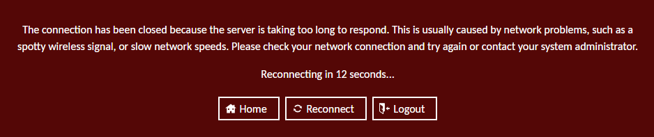

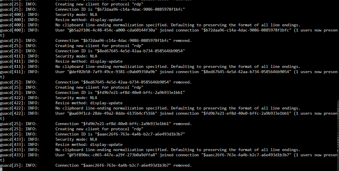

I've been having issues connecting to a Windows box via RDP since the latest update ( 1.5.4 ).  I can ping the host from the docker console fine, I can connect to the Windows machine via other RDP services fine ( RD ios app, windows Remote Desktop ).  No guac setting or network changes have been made.  I've tried restarting the docker image.  Not sure where to go from here.
UPDATE: rolled back image with :1.5.2 tag and its back up and running for me.
Edited by sentient-russ
Update
@sentient-russ I’m not sure what’s going on. I’m not having any issues on my end. If you try upgrading again try also looking at the tomcat logs (catalina.out file).
