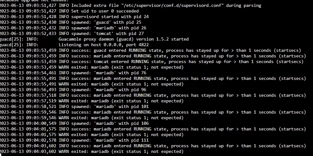

Hey Taddeusz - first off I wanted to say how much I appreciate you maintaining this Docker image for Unraid.  It's been a big help!
I am running 1.5.2 and having a snag - it looks like mariadb just starts and stops nonstop.  I did experience the issue with 1.5.0 and downgraded as necessary and then moved my install back to the current release.  I know it worked successfully since then, but today when trying it (first time in several weeks, FWIW), I can't log in.
Here are my logs.  Any suggestions would be greatly appreciated!
