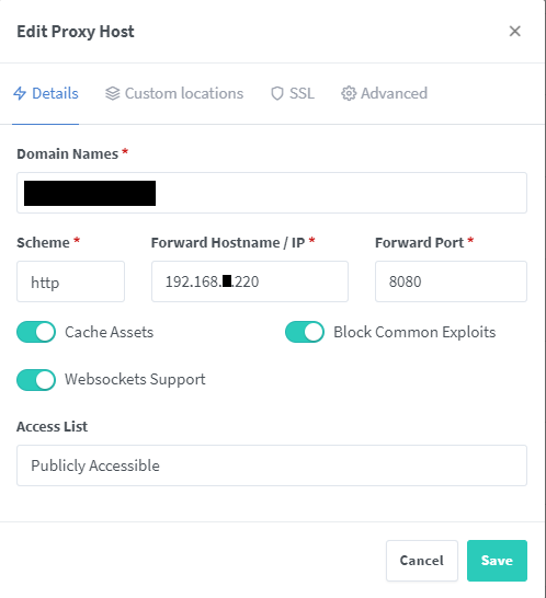

I just installed this docker and at local point everything is working okay.
I've set everything up using the video of SpaceInvaderOne:
But I cannot add it via NginxProxyManager to access it via remote.
The container is set to custom br0, with ip 192.168.x.220 and as port 8080.
So that is what I set to NPM, but I get a 502 bad request error while going to the remote access.
As normally this are the settings in NPM for the ApacheGuacamole docker, to forward it to a remote address.
Also see these screenshots:
I hope I've posted this in the right thread, as NPM and ApacheGuacamole are 2 different dockers, so choosing the right one was difficult for me.
Kind regards, and thanks in advance!
-- Rik

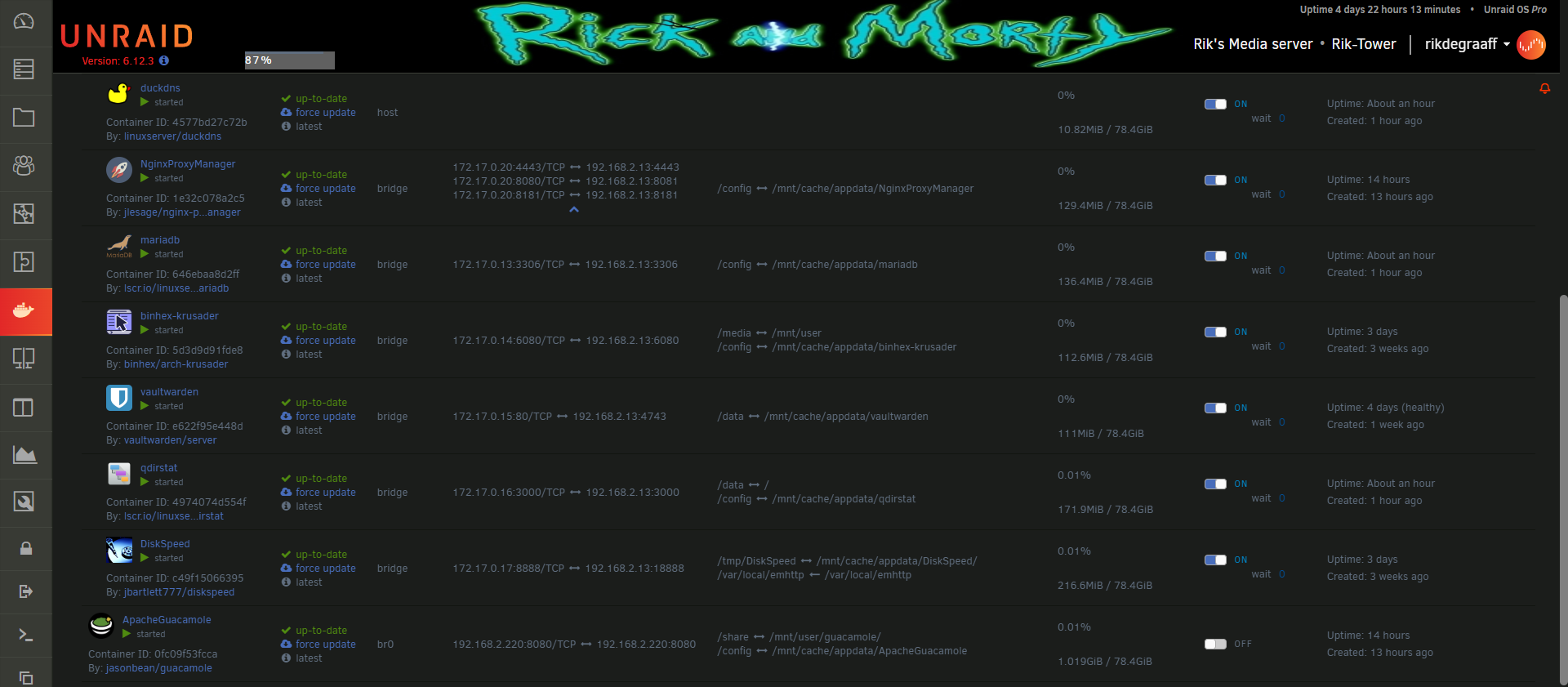

Got it, here's my docker overview.
296365892_20230818npmdockerandguacamole.thumb.png.eecf6ee0f8697d80ea80598492bcf7f6.png

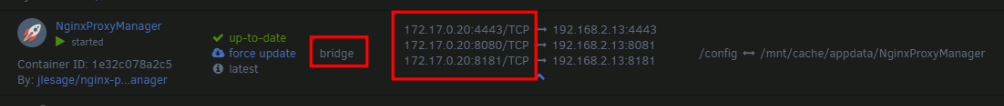

8 hours ago, alturismo said:
and how is your NPM setup ? also custom:br0 with its own IP or on the bridge ?
there was your fail answer ... its on bridge ...
so now we come back to ...

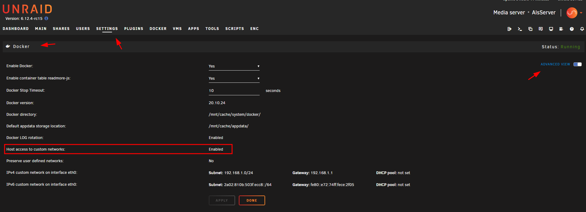

if its not also on custom br0 with its own IP, have you enabled host access ... in Docker settings (advanced view)
like this ...
and sorry to say ... but this makes no fun to help when you dont read properly ... and this belongs now more to the NPM Thread overall ... its not guac related and we shouldnt spam this Topic more and more ...
like this ...
http://upload.forums.unraid.net/live/monthly_2023_08/image.thumb.png.826df472f195d2fd835a59aff3e6061b.png
Sorry, but I really believed my docker was on custom br0. That's how I installed it. Because that's what I saw in SpaceInvaderOne's video on YouTube.
1000 times sorry for that. I understand that it is so no fun to help. Sorry.
Edit: I am going to fix it right now, according to your post. So I need to turn on that thing in docker setting. Thanks for helping a n00b.
Edit 2: @alturismo thanks it works now on remote! You're the best! [emoji1305]

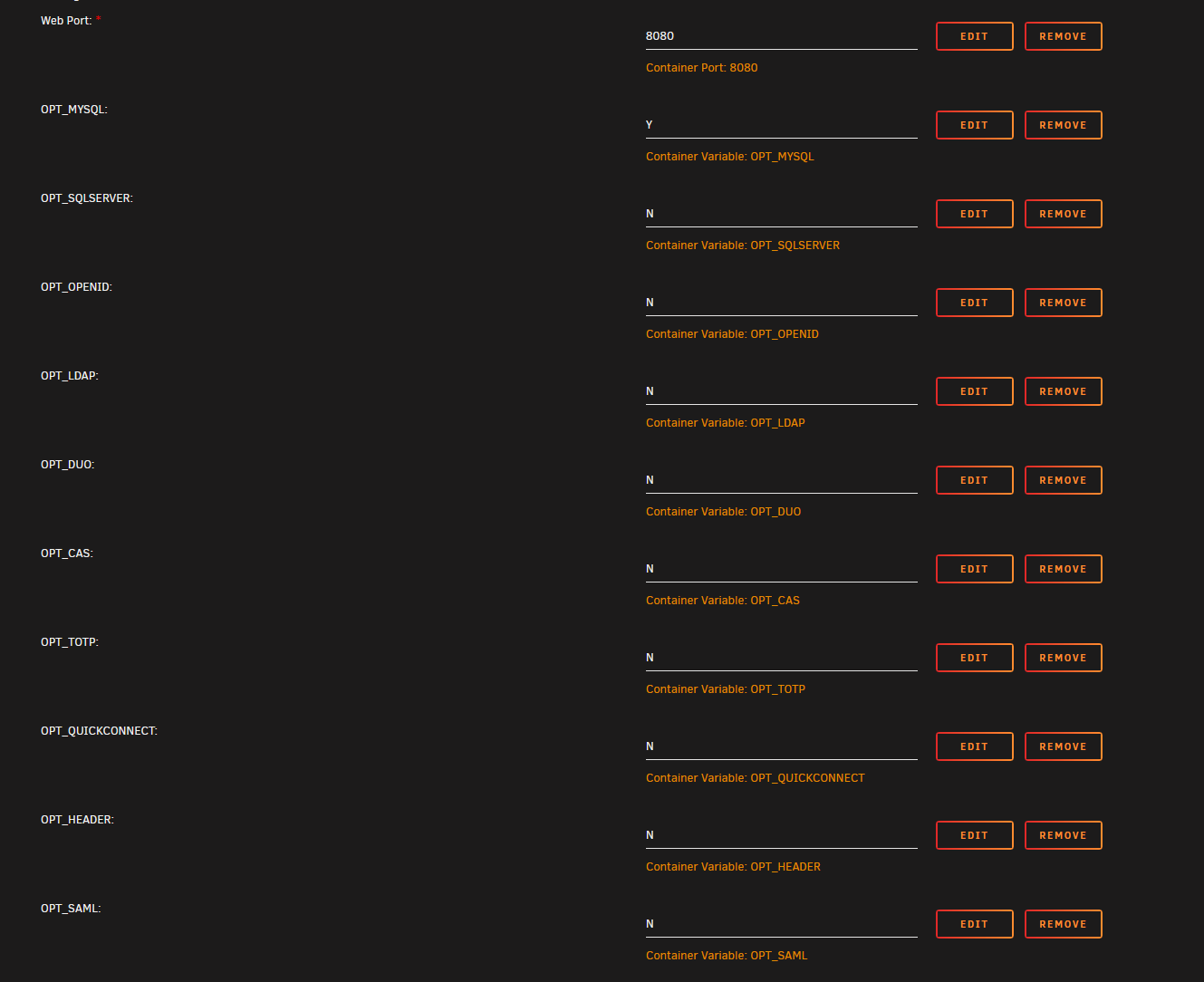

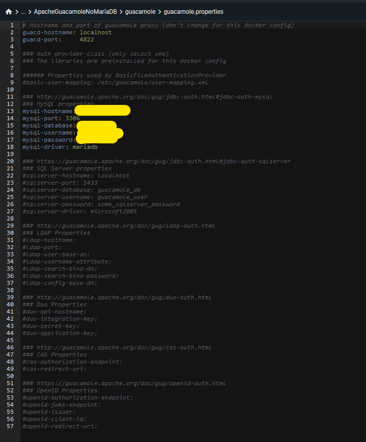

Hello, can you help me? I'm using the nomariadb version because I want to use my existing mariadb docker container.
I'm using br0 and here are the template settings:
Then I followed this https://guacamole.apache.org/doc/gug/jdbc-auth.html#jdbc-auth-mysql
1. I downloaded the auth extension guacamole-auth-jdbc-mysql-1.5.3.jar and copy to /extensions folder
2.  I downloaded driver mariadb-java-client-3.1.4.jar and copied to /lib folder (Note: I also tried the mysql connector and changed mysql-driver in properties to mysql but no avail )
Then I update my properties file:
But I can't connect to login page(Note that I restarted already the container):
When I set the OPT_MYSQL to N in the container template, I can get to the login screen but I cannot login using the defaut username and password guacadmin
In the catalina.out log, I see this error:
Loading class `com.mysql.jdbc.Driver'. This is deprecated. The new driver class is `com.mysql.cj.jdbc.Driver'. The driver is automatically registered via the SPI and manual loading of the driver class is generally unnecessary.
22:04:52.307 [http-nio-8080-exec-5] WARN  o.a.g.e.AuthenticationProviderFacade - The "mysql" authentication provider has encountered an internal error which will halt the authentication process. If this is unexpected or you are the developer of this authentication provider, you may wish to enable debug-level logging. If this is expected and you wish to ignore such failures in the future, please set "skip-if-unavailable: mysql" within your guacamole.properties.
22:04:52.311 [http-nio-8080-exec-5] ERROR o.a.g.rest.RESTExceptionMapper - Unexpected internal error:
### Error querying database.  Cause: java.sql.SQLException: Unknown system variable 'transaction_isolation'
### The error may exist in org/apache/guacamole/auth/jdbc/user/UserMapper.xml
### The error may involve org.apache.guacamole.auth.jdbc.user.UserMapper.selectOne
### The error occurred while executing a query
### Cause: java.sql.SQLException: Unknown system variable 'transaction_isolation'
Can you please check?
I'm using Mariadb official docker. It says version 11.0.3
Edited by HHUBS
