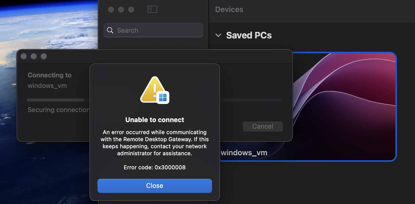

I am trying to connect to my RDP sessions remotely (not on my local network) without a VPN. When I am using the Windows App to connect to the RDP session, I'm not sure how to get the Windows App to point to the apacheguacamole instance I host at rdp.mydomain.io.
I tried to use "[email protected]" and "rdp.mydomain.io\guacadmin". but there is no activity in the the apacheguacamole logs.
That’s not how Guacamole works. It’s a regular web page that you open in a web browser and use through a web interface.
I was hoping it could act as a gateway for clients to connect to a host.

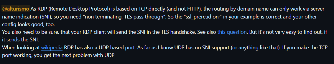

there is a "idea" howto ... nginx ssl tls stream proxy ahead of the reverse proxy ... but not so easy.
https://gist.github.com/kekru/c09dbab5e78bf76402966b13fa72b9d2
i once gave it a try but never got this to work, from my last approach and looking for help
g luck, if you make it, let us know ;)
