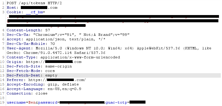

TOPIC: TOTP field not showing on hosted site.
I have set up TOTP for ApacheGuacamole and it is working on the local host fine.
I have reversed proxied (Using NginxProxyManager) it to a custom domain and it worked without the TOTP but not with TOTP enabled the page is displayed but
there is no entry to type the one time password.
The network response when clicking the Continue:
POST https://vm.domain.com/api/tokens
400 Bad Request
[EDIT] - SOLVED:
One of my Cache Drives was completely filled.
Freeing up space on that drive resolved the issue.
Edited by BMCave
400 Bad Request
I i modify the post request on the first login page and add the one time password in it seems to work.
On 4/4/2022 at 4:36 PM, Taddeusz said:
@BMCave Have you tried clearing your cache?
That was indeed the issue! One of my shares were set up incorrectly and filled one of the cache drives once clearing the drives it was working as expected.
Is there an explanation as to why this would affect something like this?
I actually meant your browser cache but that would probably cause all sorts of random weirdness. In this case it was probably having issues writing to the database.
