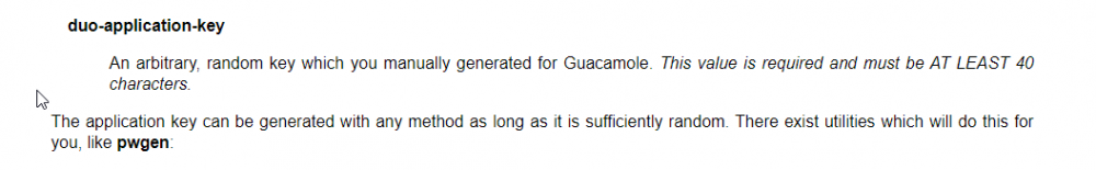

I have question i use the web sdk
Client ID is Duo Intégration ?
Duo Application the key is 40?
Now i have this window
Thank You

@Taddeusz Hello yes i have follow.
Duo integration change the name is Client ID.
I have the folder extension and the auth duo is created automatically after "Y" enable DUO on the Docker.
Duo application, i have create my key 45 characters.
@Brian5542 Are you editing your guacamole.config file in Unraid or in a Windows text editor? You need to make sure the file has UNIX line endings and no extra spaces at the ends of the lines.
@Taddeusz yes i have delete the space line.
I have trie with change the time on unraid and the docker with time London. Is the same ...
@Taddeusz  Hello
Thank you
Yes on the settings DUO
Now is working :)
Space line
Time Zone
The key Duo Application

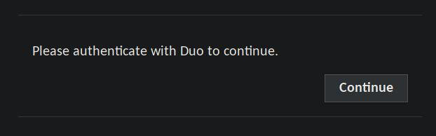

So I can get Duo authentication working with this container ok.  The strange thing is that this only works when I connect via the local IP of the container internally.
When I try and connect through my Nginx reverse proxy it shows me this:
When I hit continue, I just get:
It never attempt to send a push or anything.  Has anyone else got this working through Nginx?
11 hours ago, Taddeusz said:
@nug What browser are you using? Try refresh your browser's cache by hitting ctrl-f5.
...and I'm an idiot.  Thanks very much mate!

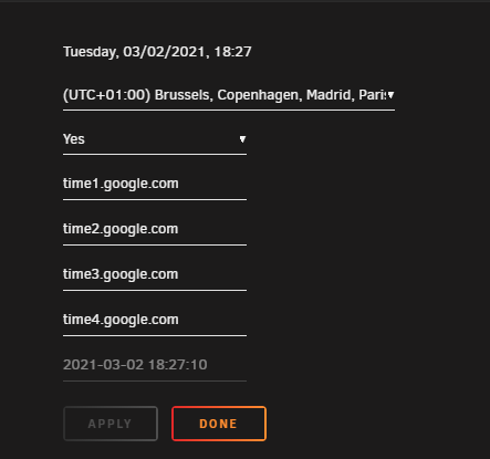

Hello! I have installed Guacamole according to the SpaceInvaderOne video but when enabling TOTP, I get to the login QR code and I am able to add the MFA to the Microsoft Authenticator, but it continually tells me "Verification failed. Please try again". I have tried a clean reinstall, and clearing browser history and a different browser. I have also tried a different MFA app. Nothing seems to work. Any ideas? Thank you very much!
8 hours ago, CybranNakh said:
Any ideas?
is time in your server in sync?
Look to be, yes. Using NTP, correct timezone, and google time servers.

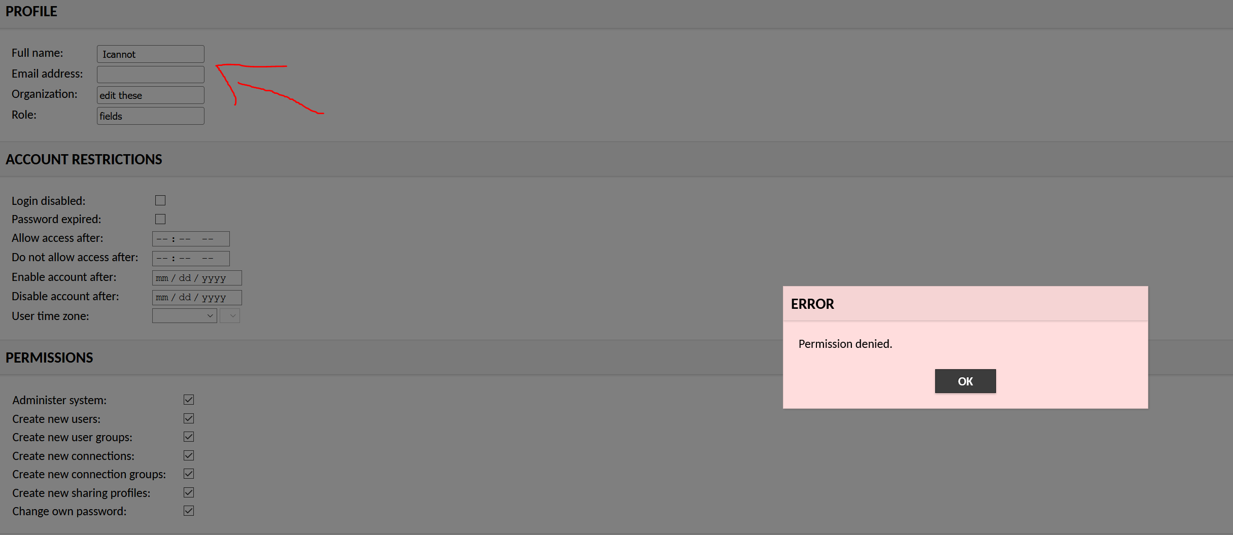

Everything seems to be OK with the new admin user. However, I cannot edit the details of the new admin user (see attached) Not to sure why that is the case, any ideas?
Edited by bombz
On 3/28/2021 at 10:14 AM, Taddeusz said:
They definitely need better management of 2FA/TOTP.
Yes, I suppose no one knows a proper fix for my work around. Perhaps in time as the docker updates in the future. My workaround seems to be OK, but I would like to clean up AG docker so so I can better manage the users.
Thank you for all the hard work, it's a really great docker!
Edited by bombz
