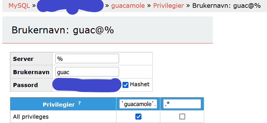

Thanks for the reply. I already tried all that. As you can see from screenshot, I created a database called guacamole and a user guac for it. I added this info to guacamole.properties. When I tried to run the script though, I get:
/mnt/user/appdata/ApacheGuacamoleNoMariaDB# cat mysql-schema/*.sql | mysql -u root -p guacamole
-bash: mysql: command not found
cat: write error: Broken pipe
I did this in unraids terminal. I also tried it with the user 'guac'. In the guacamole.properties I tried both localhost and the local ip for mariadb (192.168.0.10). any suggestions?

move the 2 files to the appdata folder from your mysql docker and run the commands from the sql docker shell you use, not from unraid and not from guacamole docker ...
well that did the trick. got it up and running with rdp now! thanks a lot :) apprecaited
