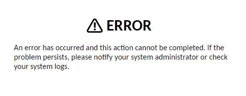

I have an ongoing issue with Apache Guacamole when logging in at work.
I enter my username & password without any issues, then i enter my 2fa code and get presented with the attached error screenshot.
When I turn off 2fa for Guacamole and log in i also receive the same error.
The only way i can log in is to VPN into the server from my mobile, create a new user in Guacamole with 2fa turned on, then log in with the new user credentials on my work pc, scan barcode to google auth app to set it up, then i have access to guacamole. Once i navigate away from the Apache web interface and navigate back i get the above error once again and i need to delete the account over the vpn & repeat the new account setup to gain access again.
Any advice?
may some issue since the latest mariadb update ? in case you use mariadb externally from lsio
I've only been using it for about a week so I've nothing to compare to. I'm not using an external db though.
ok, then it must be somthing with your 2fa ... as im not using this feature in my reverse proxy setup im out.
I don't think 2fa is the problem because I get that error when it's turned off as well as on.
anything in the logs ? i know this error message when access to database is not working, so i wonder what it could be ...
So I jut tried to log in and work and it failed. The usual error. This is on today's docker log.

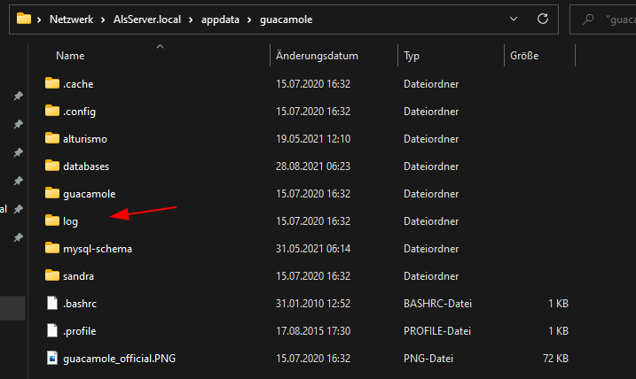

the docker is working fine, thats prolly not the place to look for ;)
i would start with the available logs here
i've zipped all the logs in that folder and attached. Whats jumping out at me is the following error from the catalina.out log. I would be happy to try trial and error it but i don't know where to start with increasing the client timeouts or adding "autoreconnect=true" to the configuration. Do i need to log into the SQL server to make those changes or can they be made from the docker parameters?
<4>Execution of ping query 'SELECT 1' failed: The last packet successfully received from the server was 20,713,706 milliseconds ago.  The last packet sent successfully to the server was 20,713,706 milliseconds ago. is longer than the server configured value of 'wait_timeout'. You should consider either expiring and/or testing connection validity before use in your application, increasing the server configured values for client timeouts, or using the Connector/J connection property 'autoReconnect=true' to avoid this problem.

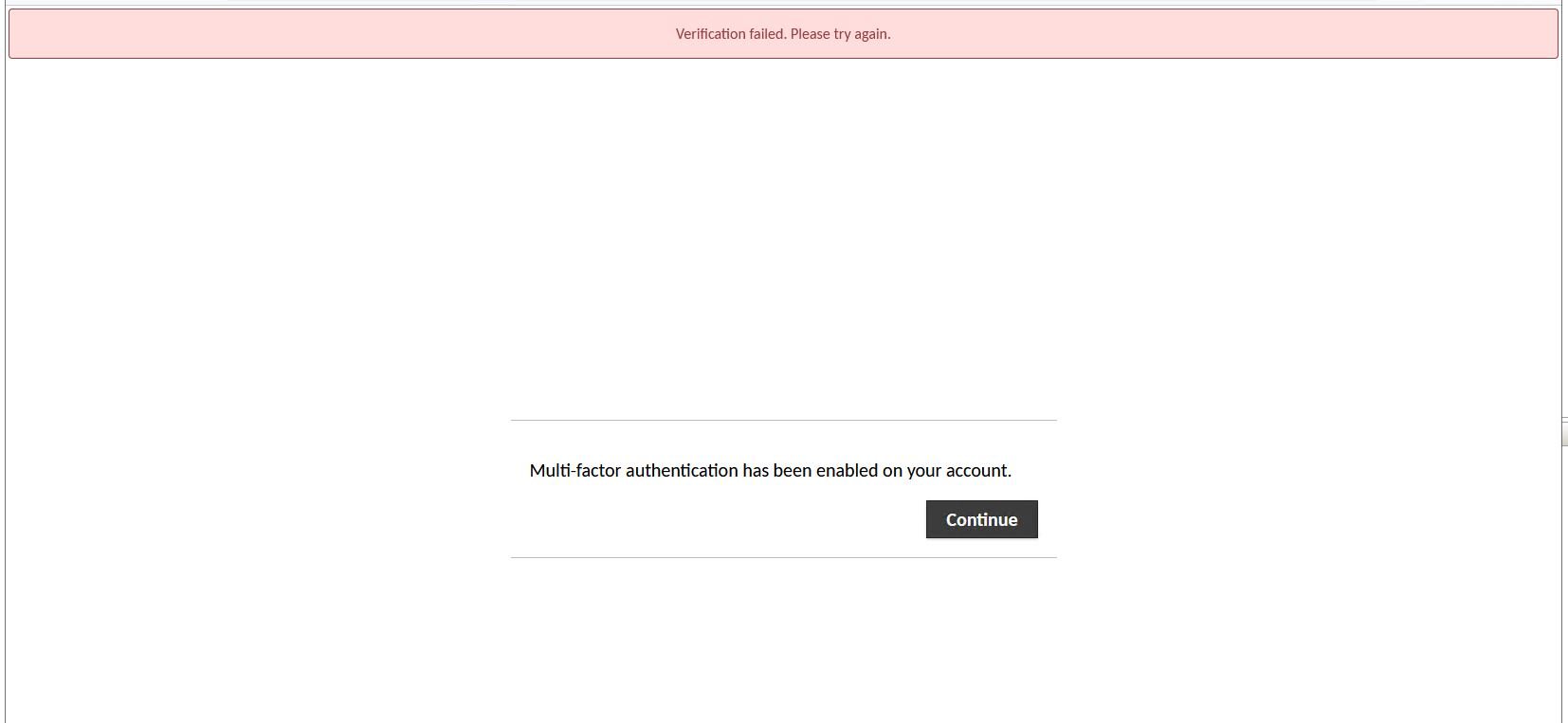

I would bet this has been answered before, but I was unable to find it.
I just loaded up this docker with the TOTP option enabled.  I go to login with the default guacadmin account, and it pops up with Multi-Factor authentication has been enabled on your account, with just a continue button.  I click that button and it tells me verification failed.  How do I get past this?
I am having the same issue using nginx proxy manager, if I go to the local address then it works fine, I have other sites where I user built in TOTP are fine, so is Authelia, I tried clearing browser cache, using different browsers, turning off caching on nginx proxy manager, cleared cache on cloudflare, put cloudflare into dev mode (turns off all caching).
I was able to register and get qrcode first time around but that was done using the local address.
Was able to fix the issue by creating another user, and then registering that user via the reverse proxy i.e use the external fqdn I setup in cloudflare and nginx proxy manager, the Authenication field then appeard after logging out and back in with new user via reverse proxy, then logged out and tried my origional user again and the field appeared as it should, seems like even though I cleared the cache something didn't clear prorpely I have removed the new user and it's still working see below
