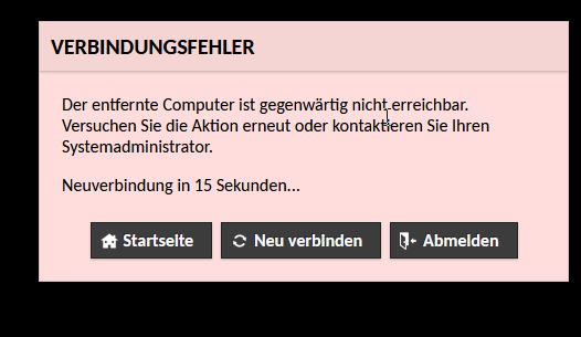

Hello,
I have problems with ssh and guacamole to logon to Unraid. Guacamole says that the server is not available. Per Putty with the same IP and port it works but or also to a VM it works. What could be the reason ?

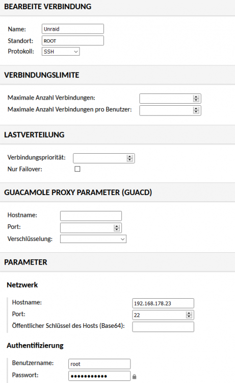

Config Guacamole:
Not working:  IP 192.168.178.23 Port 22 Protokoll SSH

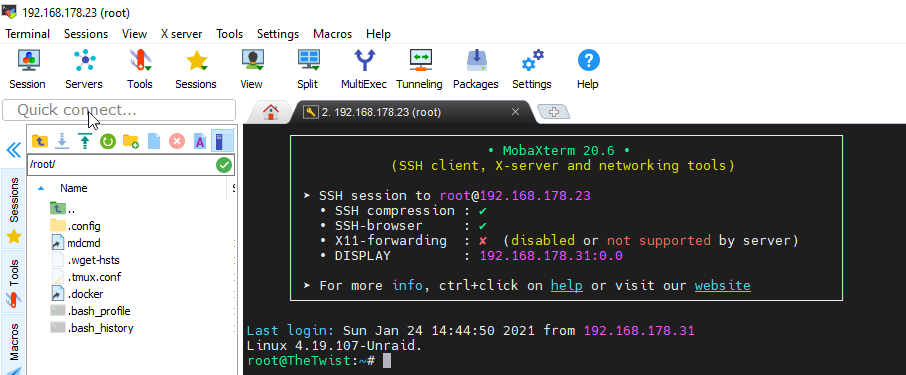

With Putty it works :

Why can't I reach the Unraid server from the Guacamole container? Any idea?

@Thorsten Is your Guacamole container set to be on a custom network? If so this would be the reason you cannot connect to Unraid’s SSH server. This is by design. For this to work your container network  must be set as Bridged.
Yes it is set to Custom: br0 with static ip. This is the same like SpaceInvader One Video. He do the same. With him it does not work for me.

This would be the reason connecting to Unraid itself doesn’t work. The network must be set to Bridged. I have mine set that way for this very reason. For my reverse proxy to work I have to specify my unraid IP address and the port for Guacamole.
Okay with Network Mode Briged I can use Guacamole to establish an SSH connection to the Unraid server.
