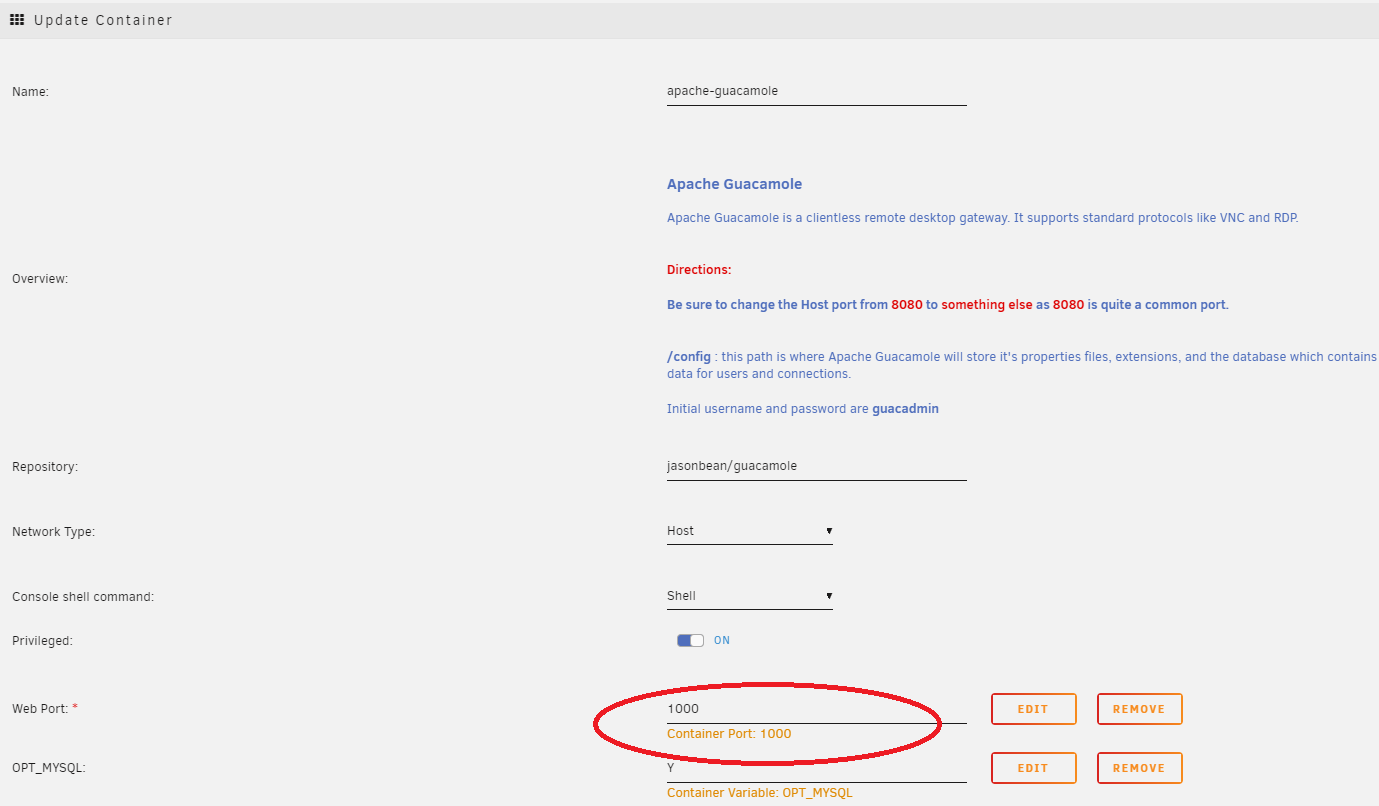

Why s my port not changing from 8080 to 1000?
That’s just the description, what does the dialog look like?
Because you are in host mode, which doesn't remap. If you change the application itself to listen on 1000, it should.
