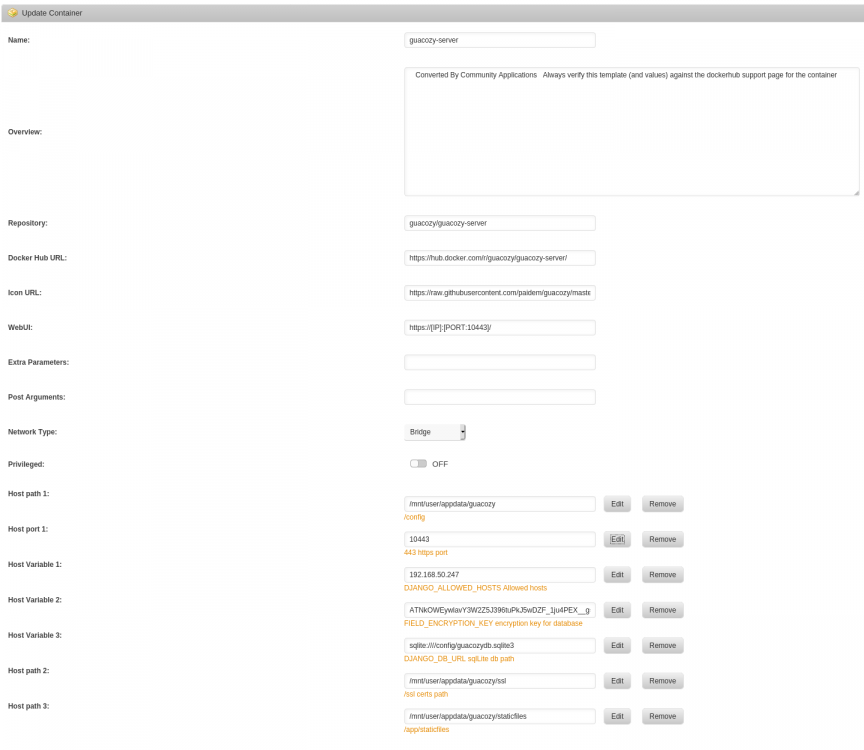

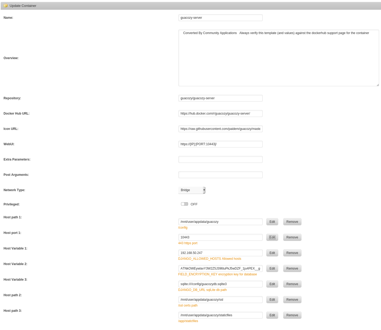

14 minutes ago, kaiguy said:
Awesome news! Would you be willing to share your Guacozy setup?
No probs, see pic. attached.

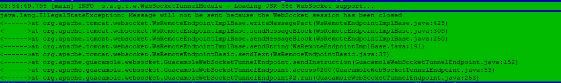

Here is a screenshot of what I can see from that log file.  Sorry, I'm remote now and can only seem to access these files through terminal so I took a screen shot:
That first message appears numerous times throughout the log.  The messages below only appear that one time.
