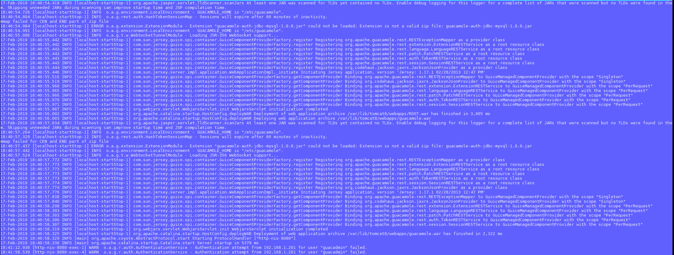

Couldn't post my catalina.out due to permission problems, but here's a screenshot. Not sure what to make of it.
@Schwiing Stop your Guacamole container and then in your Guacamole appdata folder go to guacamole/extensions and delete the guacamole-auth-jdbc-mysql-1.0.0.jar file. Then go to guacamole/lib and delete the two MySQL-connector files. And then start it back up.
If you’re still getting that error then you probably need to delete the container and reinstall it after deleting those same files again.

Tried deleting the files and starting it back up. Used guacadmin/guacadmin. No joy. Uninstalled the container, cleaned up appdata and re-installed. Deleted the files again. No joy.

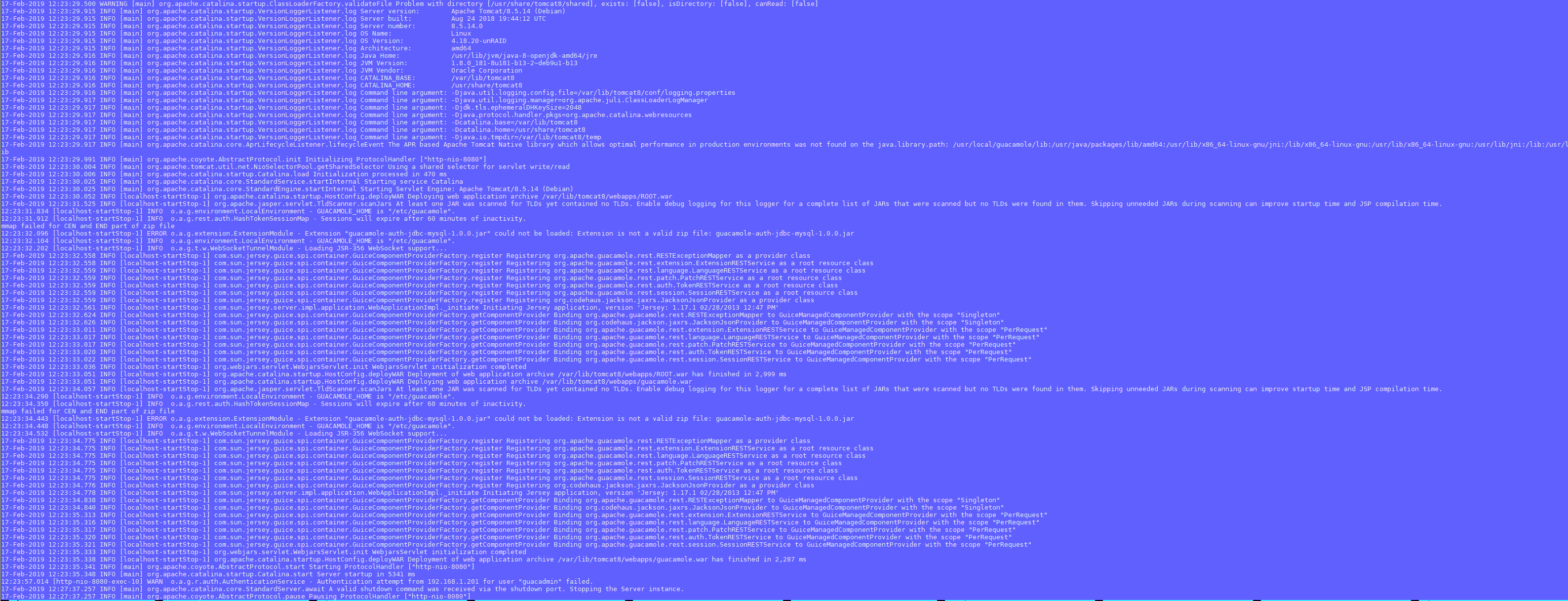

I believe so. Attached
