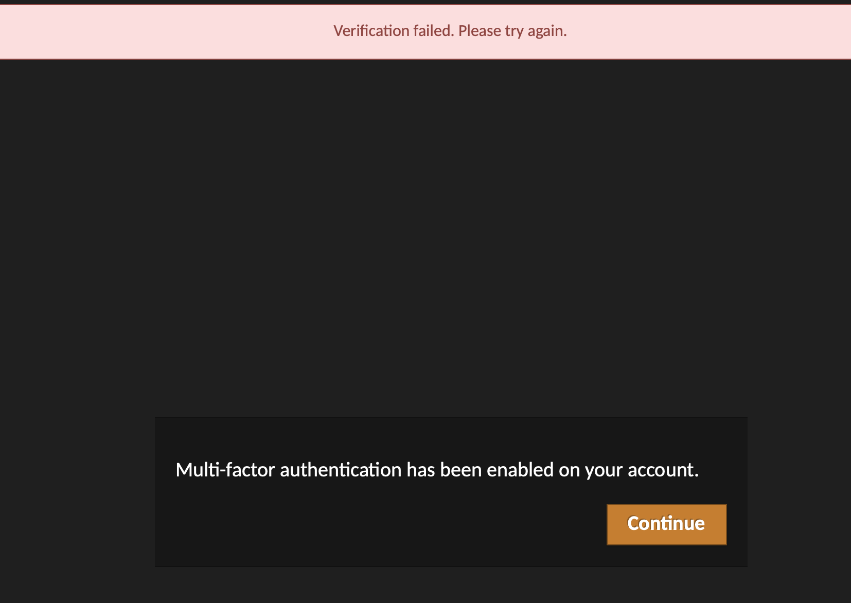

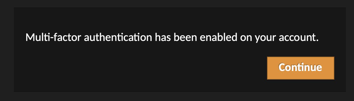

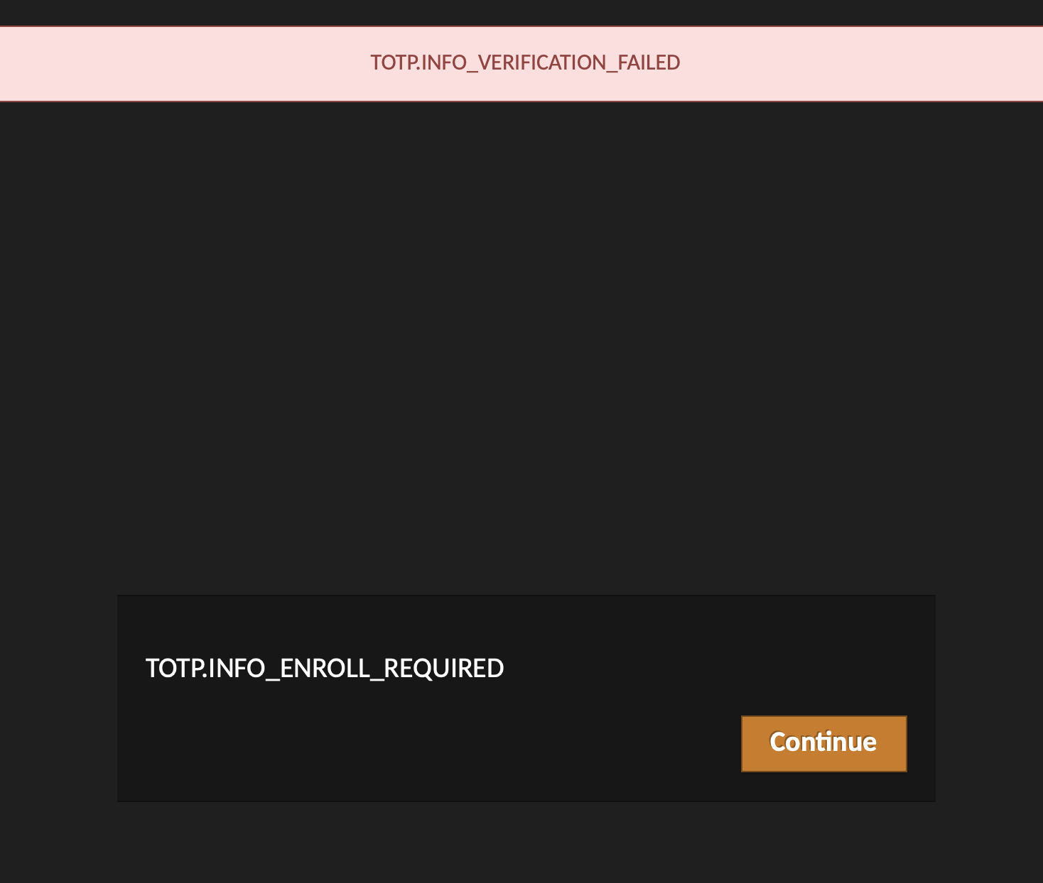

Is there something I'm missing to get the TOTP working? I've flipped the switch to Y on the option and even blew away the container thinking perhaps I had something in the DB just stuck. At this point, it will let me login with user/pass, then it says Multi Factor Auth has been enabled with the ONLY option of clicking a Continue button. The screen does a simple shake notification and the top bar saying "Verification failed, please try again."
Can you please post your catalina.out log from logs/tomcat8.
It looks like for TOTP to be supported the user must have the permission be able to change their own password.
Yes I had read that in the documentation as well. I ensured that was set on both my local user and the admin. Interestingly though I tried my user again, this time I'm receiving a new message:
catalina.out
PS - is there a way to change the admin password? I'm noticing now that it won't let me change the admin password from the default - really not a safe thing.
Edited by 1activegeek
The only way I know to change the admin password is to log in as the admin and change it in Settings on the Preferences page.
That looks weird. What browser are you using? I would suggest Ctrl-F5 to force bypassing your browser's cache.
Ya I thought it looked odd. Thank you though, that was foolish of me to not try clearing the cache. That was it!
It is still odd though that I'm not able as "guacadmin" to change ANY of the settings on the guacadmin user. I had to login as my user, set with permissions for everything, and change them for that account. Little weird, seems like some sort of wacky permissions bug?
Anyhow - all set now. Thanks for the work on this, now with OTP I feel better opening this up without hiding it behind my proxy. Though I'm going to look at setting up Fail2Ban in conjunction anyway.
