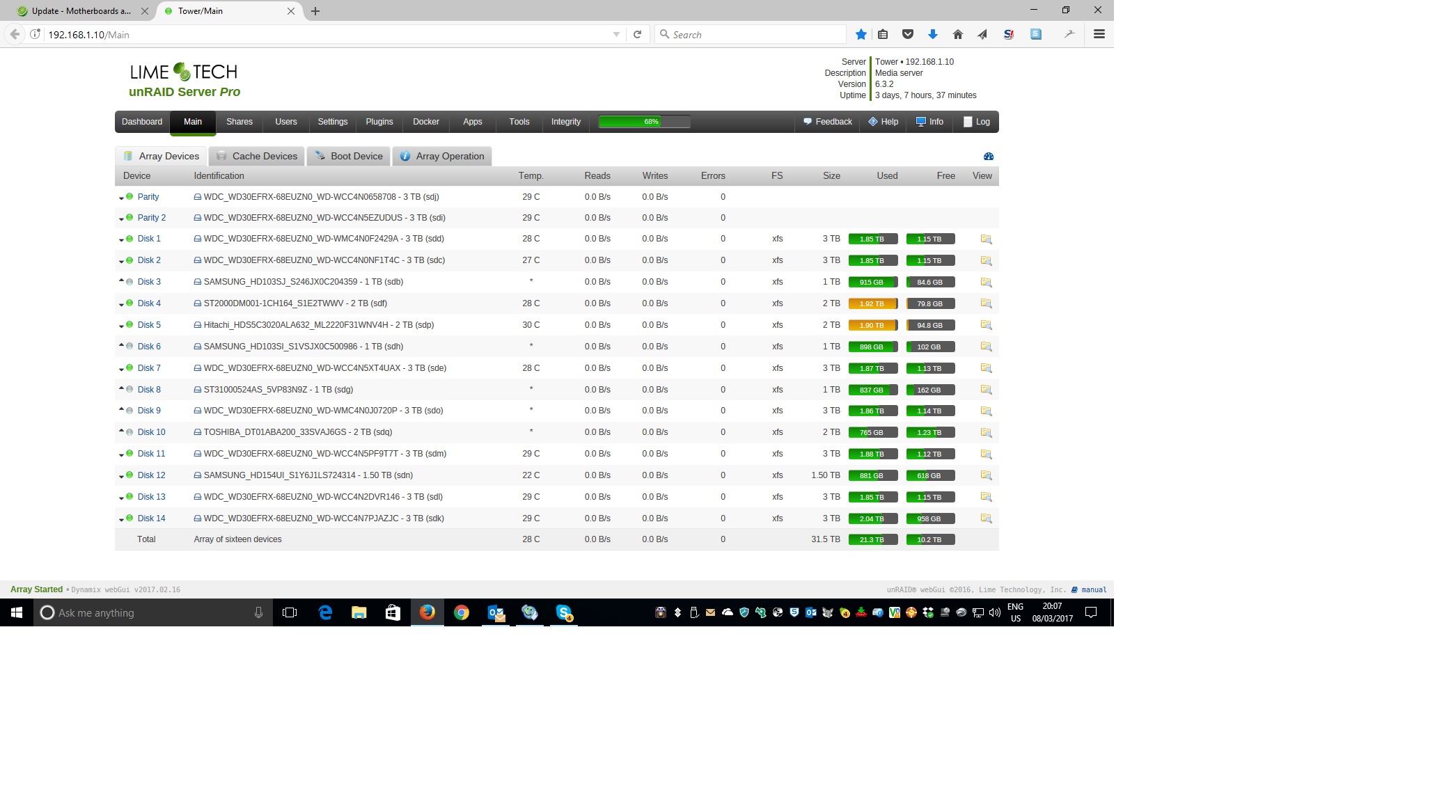

Easier to do with a screenshot of the Main display tab showing all the drives.

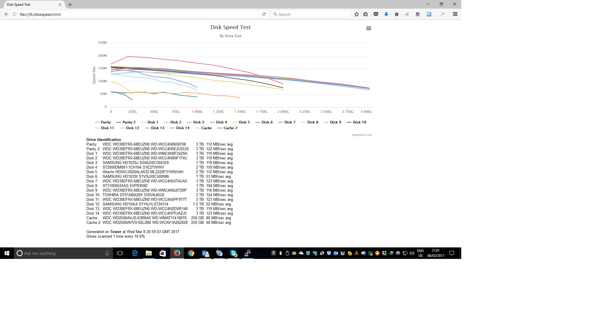

Use this:
Nice graphical display of speed of all disks.
See attached screenshot
I'd start by replacing that 1.5TB Samsung drive and then all the 1TB drives. Also check your MB manual because I know that one of the members here caught a problem I was having with my H310 and slow parity checks, it was that the 8x slot I had it in was actually running at 4x speed, so make sure the 8x slot you have yours in is actually running at that speed, or if you have another free 8x slot or 16x slot, try it in those slots to see if that fixes the problem.

Looks like I have a few slow disks!
