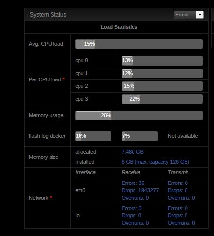

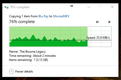

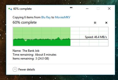

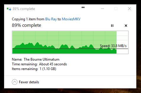

What are typical gigabit network transfer speeds to your Unraid boxes from Windows machines?  When transferring large files like MKVs?  I see posts about guys saturating gigabit connections and averaging over 100MB/s.  I average 40-50 MB/s.  I never saw an improvement when I started using cache drives a long time ago either nor did the performance increase when I "upgraded" the cache drives.  I am currently using 2 500GB VelociRaptor 10K RPM drives in a btrfs cache pool.  I verified all my network wires today with a cable tester.  Any ideas?  I would LOVE to get 100 MB/s transfers.  Ethtool shows connected at 1000 Mbps.   Thanks, Andrew

You're limited by your spinners for cache. Those WD Raptors are dog slow with writes compared to even modern SATA drives and even more archaic compared to SSDs.
Ok.  I will try disabling cache for my MKV folders and try writing directly to the array.
Just out of curiosity I got 163 MB/s zeroing speeds when prelcearing those disks.  Is that not a good indicator of write speed?
40 to 60MB/s seems normal array write speed in default read/modify/write mode, you can change to reconstruct write (aka turbo write) and it should be considerably faster at the expense of all disks spinning up for writes. (settings -> disk settings)

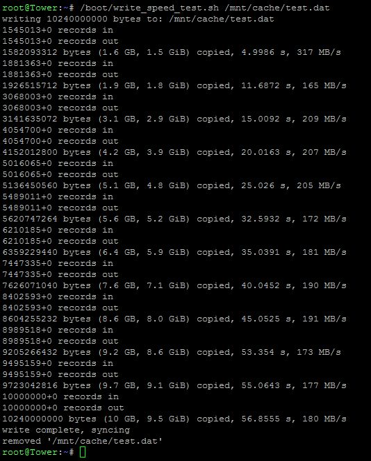

For the cache speeds seem low, try the script attached to rule out any network issues, copy it to root folder of your flash share and type:
/boot/write_speed_test.sh /mnt/cache/test.dat

Ok, so copy that attached file to the root of the flash drive and type that line in a telnet prompt?

Does this mean it's not the cache drives?

Sorry, edited the post above do take out the first attempt at running.  I canceled the test since I remembered I had the "Mover" running.

NO =>  the spinners can easily exceed Gb speeds for writes.     This may be a network issue;  or it's possible the shares aren't configured to be cached -- in which case the writes are directly to the array ... in which case 40-50 MB/s is a reasonable speed (actually it's fairly good).     If switching to reconstruct write mode (aka "turbo write") speeds things up, then that's indeed the problem.
allischalmersman =>  Are you sure the shares are configured to use the cache?    They have to be configured on a share-by-share basis.

Did you notice the receive errors and drops in your Ethernet stats?  I think I would start with that issue.  Local speed to your cache drive looks fine.  Maybe you are having problems with the switch connecting unRAID and your Windows system? Bad NIC?
I have used multiple different switches and multiple PCs, no difference. This is a PCI Intel NIC and from what I read the drops are not abnormal? The errors idk about. I have another PCI NIC I could try. I have not tried another router. Connnections look like this PC>router>wall patch to basement>basement patch panel to switch>switch to tower. I will try connecting a laptop directly to the switch the Tower is on and try a transfer. Will that eliminate the router as a variable? Not a cheap router either. Its a Netgear R8000

I know that I have a friend who complained about similar speed with his gigabit network.  Last week he finally replaced the switch and is now seeing gigabit speeds (100MB/sec. +). Drops are not uncommon in congested networks. But your counters are pretty high - especially if you've been restarting while troubleshooting this issue. Yes, if you connect directly to the switch you will remove the router and most of the cabling in your test.  Good idea.

So now you now it's not a cache or unRAID problem, most likely a network problem, you'll need to test with different switch/cable/NICs until you find the culprit.

Reconstruct write mode makes absolutely no difference
Scratching my head here.  Are there some settings that I don't know about?  Are there some montherboard BIOS settings that can control a PCI NIC that I don't understand?  What would you guys try next?  Would logs help?
