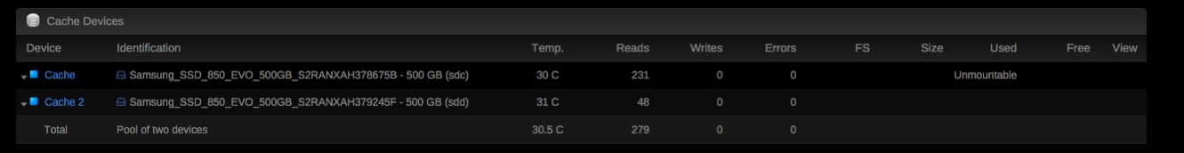

The above steps are complete....the array is online, but the syslog shows about 1000 errors on ATA4 and btrfs errors. Any thoughts?
Parity check on hold until I can get this sorted.  Thanks!!
Edited by Joseph
Replace SATA cable on SSD serial ... 245F.
working on it.... you're gonna have to show me how you figured that out!
OK, so the cable has been replaced, however Cache & Cache 2 are online, but is no longer mountable.
Also, the error count is down to 34, doesn't appear to be ATA related, but do you think any of them need to be addressed?
FYI, I disabled the onboard Marvell controller in the bios.
Edited by Joseph
ATA errors are gone, ACPI errors can usually be ignored, bios update may help some.
Problem is that the bad cable corrupted your cache pool, assuming pool was default raid1 try powering down, disconnect cable to SSD ...245F, power back back on and see if it mounts, if not use this FAQ to try and recover your cache data:
