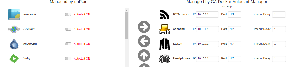

CA Docker Autostart was my first thought, however I just installed it and it doesn't seem to be working at the moment. @Squid may be able to provide a bit more info.....
EDIT: Removed all the CA plugins and reinstalled and it's working now.
Edited by CHBMB
I did not try that before, embarassingly. Seems I overlooked it after CA, backup, etc. was split up.
After a bit of fiddling, I can confirm, this does not work. The --net containers remain stopped, even with high delays (30s or more)

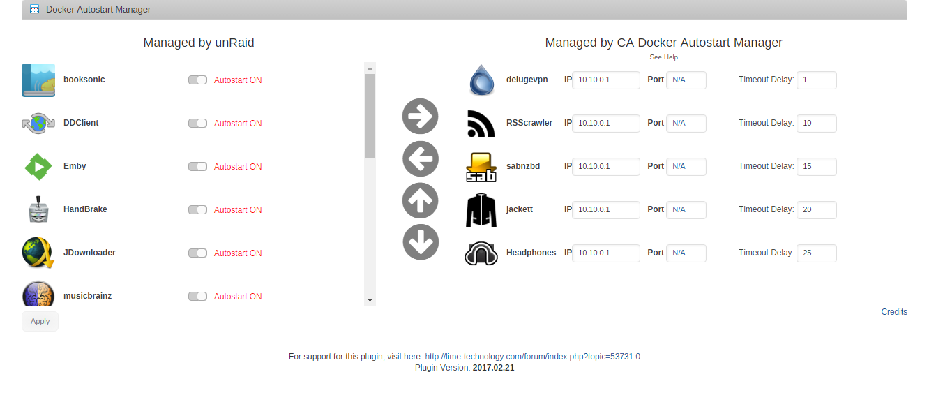

it does work with the following settings (see attached file)! Thank you.
You have to wait for the delay to run down, after docker has already launched containers the default way!

I checked again, this works totally fine. Thanks again:
Yeah I don't use this plugin to be honest as I have no need for it.  Glad it worked out well though.  Wasn't 100% sure whether it did what you needed or not.
Yeah, most times it doesn't matter about the timeout value as everything is so fast now.  But instead of timeouts, you can always use the port feature too.  (ie: set the port to be the webUI port -> and it'll wait until the webUI port is open before continuing.  See the docs
