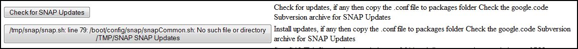

I don't think so... not yet.  I see this when I visit the User-Scripts screen after putting the two files in the unmenu directory.  You probably have not tried them with a "clean" install, where you do not have the files already in place.

I don't think so... not yet.  But you are close...  I see this when I visit the User-Scripts screen after putting the two files in the unmenu directory.  You probably have not tried them with a "clean" install, where you do not have the files already in place.

I'm sorry to say, I still get the exact same error.  A diff of the new and older versions of your buttons does not show any logic changes, just a wording change and a few unused lines removed.  The install button does not work.
Running the USER_SCRIPT_TEST line on the Linux command line shows this, all apparently destined for the "button" label.  Obviously, it does not fit.  In fact, it apparently installed the SNAP package, before I pressed anything.
test -s /tmp/snap.newfiles &&  echo "`/tmp/snap/snap-install.sh -t | tr '[:lower:]' '[:upper:]'` SNAP Updates"
/tmp/snap/snap.sh: line 79: /boot/config/snap/snapCommon.sh: No such file or directory

The commands it printed are all in upper case, which will only confuse users not familiar with linux and its need for case sensitive commands.
My system does have an existing /tmp/snap.newfiles file from a prior failed install.  You need to be able to deal with that, and of course, not install ANYTHING until the button is pressed.
The USER_SCRIPT_TEST  should not install anything.  It should just emit the label text if the button should be shown to a user, and no text if it should be hidden at that time.
I did not press anything, yet the package installed itself.  That is not correct behavior.
Next, you are installing a .tgz package in /boot/config/snap.  That is not in accordance with all the other packages installed in /boot/packages.  It really should go there (in /boot/packages).  Also, it is an older version than the one being distributed in unmenu's package manager.  You are distributing inotify-tools-3.8-i486-1.tgz, yet the one in the unMENU's package manager is /boot/packages/inotify-tools-3.13-i486-1.tgz.  (5 versions newer)  Why include inotify-tools at all.  Why not just emit a message stating its installation is required and let the package manager do its job.  That would be the correct way to handle that, and then the .tgz would be with all the other packages.
Apparently you replace the config/smb-extra.conf file with your own.
Expect that to cause MAJOR problems with many users.  Myself included.  That is simply not appropriate behavior.  You don't seem to even make a backup copy, you just blank it out.  Un-acceptable.
If I had rebooted and SNAP started itself it would have wiped out my custom settings.  Not nice.  (And remember,  I had not installed anything, I just displayed the User-Scripts page.  It modified my "go" script without me pressing any "Install" button.)  Sorry but I do not feel the snap buttons are ready for inclusion in the official unRAID distribution.

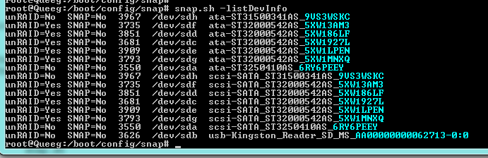

One of the new features in SNAP 0.47 is snap.sh -listDevInfo.  It's a improved version of the -listDeviceConfigurationInfo listing that highlights the serial number part of the device name.  This makes is a lot simplier to add new devices to snap.  The highlighted part is what you use when adding a drive to SNAP.  You still need to telnet to unRAID and use the command line but at least no more scratching your head trying to figure out what the serial number is supposed to be.  If you like seeing the /dev/disk/by-id/ prefix when you run it then include the snap.sh -listDevInfo long modifier.
snap.sh -a [sharename] [serialnumber]

After getting 4.7b1 up and running this month, I installed unMenu and manually installed Snap.
Got both working no problem a week ago.
Now I took another look at the OP and see instructions for 4.7 to install unMenu buttons.
I downloaded the zip (1 hour ago) as per the link, and continued with the next steps.
After going into unMenu and clicking on User Scripts, I pressed the button to "Check for SNAP updates"
It downloaded but showed an error at the bottom of the unMenu page.
The error is the same as the image posted by Joe L. except the error line is now 90.
The UPDATE Snap updates button shows up but has the error message as part of the button.
Clicking on that button results in the same button showing up but no error messages at the end of the page.

Fixed in SNAP 0.47 build 25.
Also changes to the buttons so get them again.
I was able to reproduce the error on line 90.  Thanks for reporting it.
