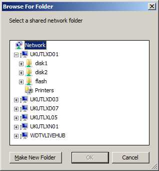

I have seemingly installed SNAP on a 2 disk (no parity yet) 4.7 final system.
However I can't get it to function reliably.
It has worked on one or two occasions, but I don't know what I did differently to the other times when it would not work at all.
By 'not work', I mean that I couldn't see my USB-connected NTFS drive as part of SNAP.
I have successfuly mounted the drive via the command line and been able to view it in MC, so the drive should be ok.
Is there any way I can capture the command line history so that someone might have a look at what I am doing (wrong)?
Thanks in anticipation

In Windows telnet window you should be able to right-click and select all and then press enter key.  The contents are now in the clipboard and you can paste into notepad.
Telnet in and run
/boot/config/snap/snap.sh -listDevInfo
Also run
cat /boot/config/snap/snap.list
Post the output.

root@ukutlxd01:~# /boot/config/snap/snap.sh -listDevInfo
unRAID=Yes SNAP=No  3522  /dev/sda  ata-Hitachi_HDS5C3020ALA632_ML0220F311TBND
unRAID=Yes SNAP=No  3584  /dev/sdb  ata-WDC_WD20EARS-00MVWB0_WD-WCAZA3244757
unRAID=Yes SNAP=No  3522  /dev/sda  scsi-SATA_Hitachi_HDS5C30_ML0220F311TBND
unRAID=Yes SNAP=No  3584  /dev/sdb  scsi-SATA_WDC_WD20EARS-00_WD-WCAZA3244757
unRAID=No  SNAP=No  3678  /dev/sdc  usb-SanDisk_U3_Cruzer_Micro_43184218C210FC6A-0:0
unRAID=No  SNAP=No  13279 /dev/sdd  usb-WD_10EADS_External_57442D574341563531333234383032-0:0
The contents of your snap.list file is:
57442D57434156353133234383032=
57442D57434156353133234383032-0:0=
57442D574341563531333234383032=elements
So what has happened is you have tried to add the drive to SNAP 3 times.  Two of those times the identifying serial number was incorrect.  I highlighted them in green.  The correct one unfortunately doesn't have the share name so it's not working.
You can either edit the snap.list file and fix it or delete the file and add the drive to SNAP once more like this:
snap.sh -a 57442D57434156353133234383032-0:0 elements
After that the snap.list file should have one entry looking like this:
57442D57434156353133234383032-0:0=elements
