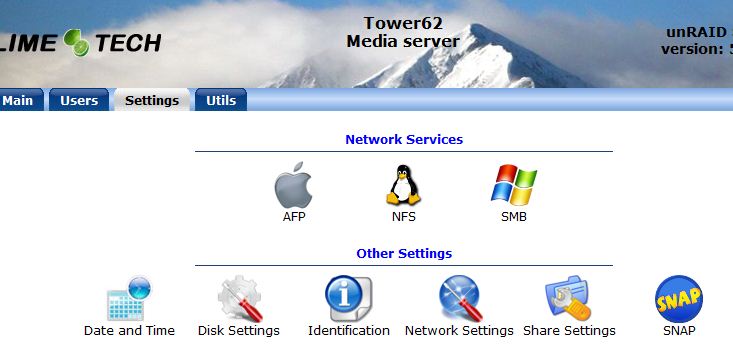

4. After it installs you should be able to run the web page.  Open a browser to this address and click the SNAP button.
                  //tower/Settings
The SNAP page has 3 tabs.  One to configure shares, one to view log files if needed, and one that will allow you to edit the SnapEvents.sh file to add code for syncing files and that sort of thing.  SNAP's main feature is to automatically mount and share devices as you plug them in.

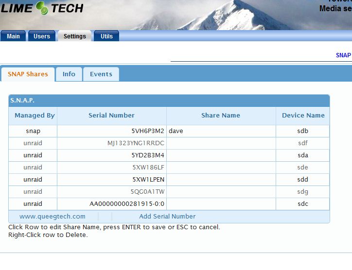

well i get the icon now
and the tabs appear...
i can add a serial number but the window that opens is not big enough
it truncates the serialnumber
once i added the serialnumber name it auto mounted it
but the "grid" stays empty
although i can use the disk and it is shared over SMB
This is likely due to the json error
  "Fatal error: Call to undefined function json_encode() in /usr/local/emhttp/plugins/snap/manageList.php on line 435" when doing a list.
The fix is to edit jsonwrapper.php and jsonwrapper_inner.php, change the require line to:
  jsonwrapper.php:          require_once 'jsonwrapper/jsonwrapper/jsonwrapper_inner.php';
  jsonwrapper_inner.php: require_once 'jsonwrapper/jsonwrapper/jsonwrapper_inner.php';
The serial number window issue should be fixed by re-installing the plugin using the same plg file you have.
Let me know if the "grid stays empty" continues after re-installing.
Thanks.
ALL OK now
just reinstalling fucked up the new share for a bit.... probably due to the fact i didn't delete the share....
but after a reboot all OK

Copying data via snap through a esata toaster speed issue.
Hi, am using the latest beta from snap with beta 5.14, am seeing the shares and can acces them. When copying from this share, the speed is 1 Mb/sec. Isn't that a bit slow? How can I check possible speed probs?
Copying from where to where?
Soory about that, I want to copy data to the array from an old sata laptop harddrive. It's a 320 Gb drive So I thought esata will be faster than usb2.
but it less than 1 MB/s.
