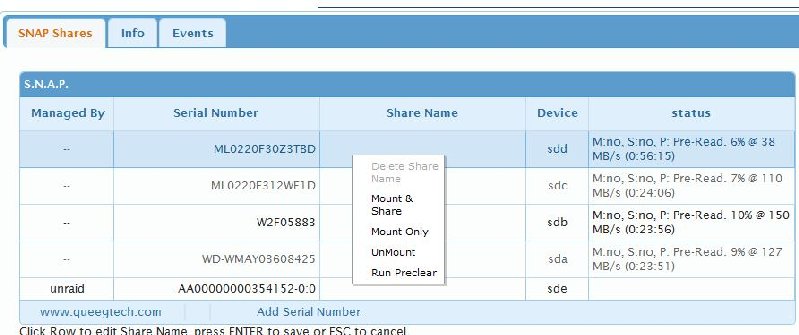

Here's  a preview of the next build.  I added some more options in the right-click context menu.  I added an option to start preclearing by right clicking on the grid row and the preclear status displays in the grid.
I also added some manual control options for mounting/sharing.  I'm preclearing 4 drives with it right now.
EDIT:
I've also made it so the status shows if a drive is already been precleared.
Towersnap_-_Mozilla_Firefox_2012-01-31_00-42-36.jpg.ee5c8bacd869c12830a84e89c3a41b58.jpg
