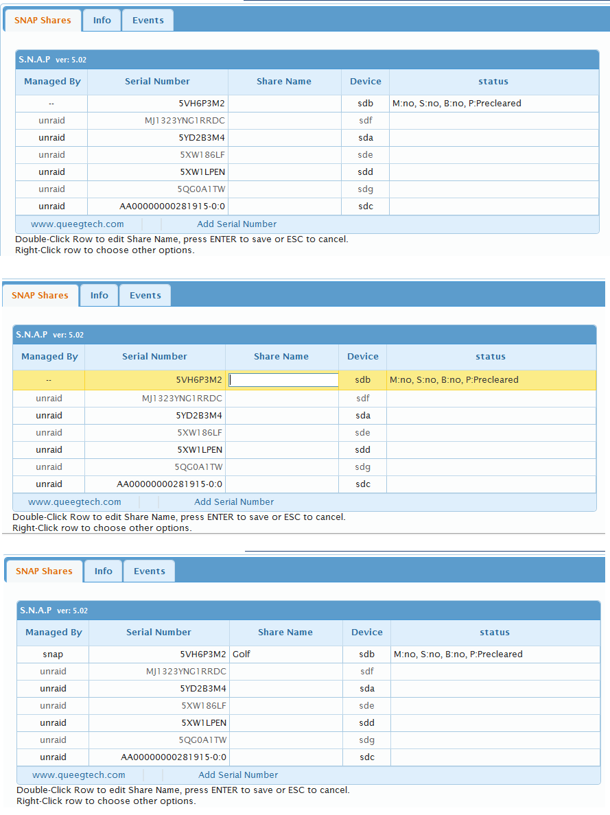

I think I need some help... Installed the latest version of SNAP on my 5.0b14 server. Precleared a drive on an auxiliary computer, and moved it into my unraid server. Snap saw the drive, but wouldn't do anything with it. Reading this thread, I figured out that it had to be formatted and/or partitioned, so I installed and ran Unmenu to take care of that. Went back to snap (rebooted several times along the way) and it can see the drive, and I can "name" a share, but when I right click on the drive (after naming a sharepoint), other then popping up a menu, nothing actually gets done. i.e. I can select Mount and share, but then nothing happens.
I did successfully share the drive thru unmenu, but I like that SNAP is built into the main interface, and looks to be a bit easier to use and understand.
Anyway, other info: I'm using a mac with firefox (and safari, and chrome) to use the snap webpages, the disk dropdown menu works but doesn't accomplish anything with any of these browsers. What am I doing incorrectly?

In the pictures, I added a share name to that drive.  But, since it's not formatted yet, the status still shows it as
M:no, S:no, B:no, P:Precleared
or
Mounted: no
Shared: no
Busy: no
Precleared: yes
If you drive is actually formatted and it has a share name then you would be able to right click on the row (with your drive) and choose Mount and Share.  It then would be mounted and shared and the status will change to show that.
A drive that is precleared is not yet formatted.  If your drive status isn't showing the P: flag then it might be formatted.
Also, if the drive is part of the unraid array it won't be touched by SNAP in any way.  What is in the Managed By column for that drive?

Attached are some screenshots. I can see my disks, set up a share name, and right click to show the drop down menu, but nothing in the dropdown menu, for lack of a better term, works. I can click them, then nothing happens. If I leave the snap page, and go back to it, the share name has been forgotten.
What other information can I provide to help figure this out?

What browser are you using?  Also, get the new version of the plugin.  It has lots of things fixed.
Latest version fixed it.
