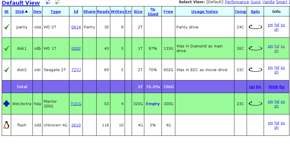

After several days, I decided to try formatting again. It seems to have succeeded, however I got this message this time
mkreiserfs hda1
mkreiserfs 3.6.21 (2009 www.namesys.com)
Warning: start=63 - this looks like a partition rather than
the entire disk. Using fdisk on it is probably meaningless.
[use the --force option if you really want this]
I'm not sure why start=63, since I have had the 4k aligned parameter set since my initial build of the machine, and this was formatted/pre-cleared in this machine.
Am I good to go ahead and start using the disk now? Since it's only a 320GB PATA drive, will the 63/64 alignment really cause any issues? My plan is to use this drive for installing MySQL, SB, NZB, etc, not within the array itself.

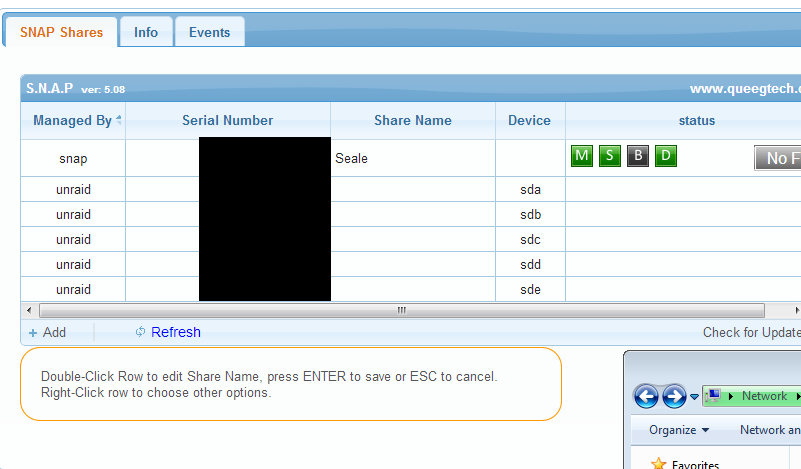

I got SNAP to work and able to mount USB drive with it but my problem is i can't share that drive via the unRAID web menu, Shares. I can see the USB drive and it's under /mnt/disk
how do i share it?

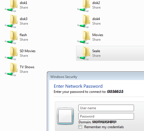

I added a portable external hard drive to my server, used snap to mount it and when go to access it through explorer is asks for a Login and password.  I've read the posts on the new security settings and still don't know how to fix it.  All of my other disks and shares are accessable without requiring a password or login.
Also once I gain access to the drive would dragging items from "TV Shows" to the hard drive "Seale" be the same as copying them over the network.  Do I have to use MC to transfer files?
Thanks in Advance.
