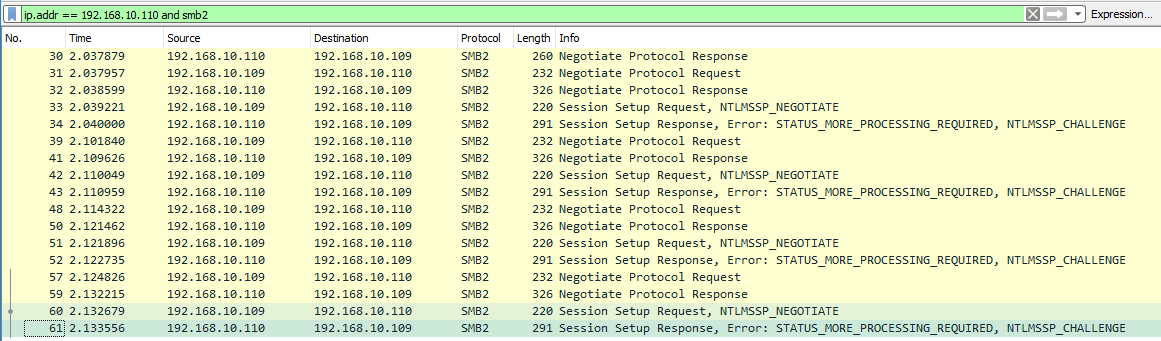

in turn I did wireshark trace of smb2 traffic to my unraid box and learn that in response to session setup request, I get
Error: STATUS_MORE_PROCESSING_REQUIRED, NTLMSSP_CHALLENGE (See screenshot attached)
Can someone please advice or help me understand what is going wrong here?

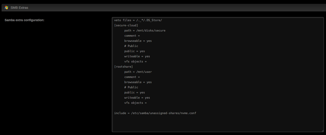

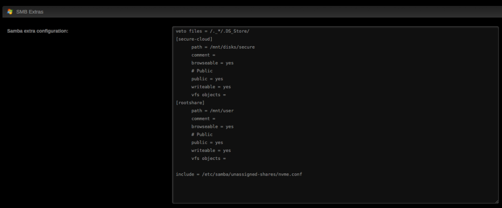

I think you are putting the smb extra as one line this will not work this way. Please try adding it like this
[secure-cloud]
      path = /mnt/disks/secure
      comment =
      browseable = yes
      # Public
      public = yes
      writeable = yes
      vfs objects =
Here is a picture of my smb extra section in the web ui.
The  first part the line with veto please ignore. I use that to veto files created by osx that i dont want.
Then i have the secure-cloud share.
The next share is called rootshare which is a share to the /mnt/user so a can have one share with all my share in so its easy to move files from share to share
from a computer on the network rather than having to login or use krusader etc.
The last line staring with include is added from the unassigned devices plugin for a share created by that.
I dont worry about security as mine is a home network, but you could change it to how you need it.
