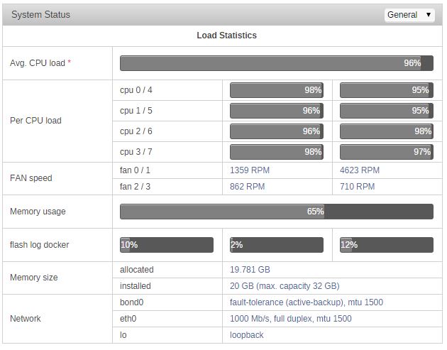

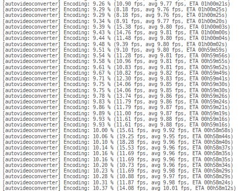

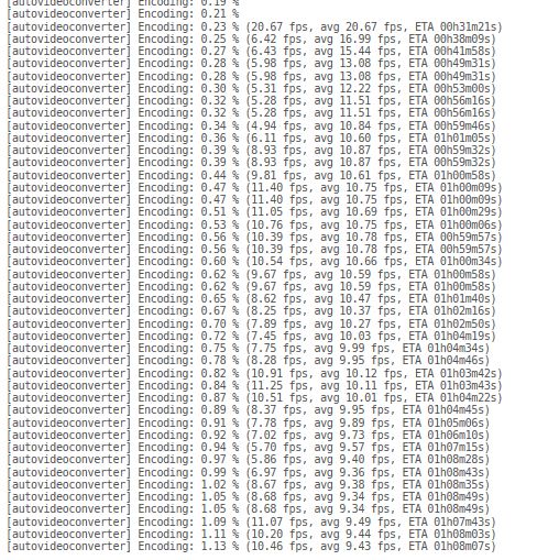

I am having performance issues with the docker as encoding X265 I am only getting approx 9fps but if I use the same profile on a Windows VM (on the same unraid server) I get 40+ fps any ideas? my CPU has all cores maxed out and no other processes running...
Passed thru videocard?  If so, would make sense
No, nothing passed through on the VM I just use X2go Remote Connection, I only use CPU encoding not GPU
Just been doing some testing using the same HEVC Presets, everything is on the same machine with the same amount of cores available and no GPU Passthrough,
Windows 10 VM Handbrake 38fps
Linux Mint VM Handbrake 41fps
Linux Mint VM FFMPEG 39fps
Handbrake Docker 9fps
Any ideas?
Also, can you try version 1.11.2?  Open container's settings and change the repository to: jlesage/handbrake:v1.11.2
Yes just with HEVC X264 seems fine!
Will change version now :-)
fps is not as consistent with this version but the net result is the same unfortunately. it is fluctuating between 3fps - 20fps.    any ideas what could be causing the slow processing? looking at the log you would think it would be slow disk speed but all my tests have been from the same 500mb file on the same disk.
Edited by mbc0
Since all your cores are almost at 100%, I suspect that there is some kind of acceleration that kicks in when you get ~40fps on other setups.
Searching a little bit on google seems to show that ~10fps is what to expect without acceleration.  I have similar results on my machine.
Do you have an Intel CPU?  Which graphic card did you configured for your VMs?
