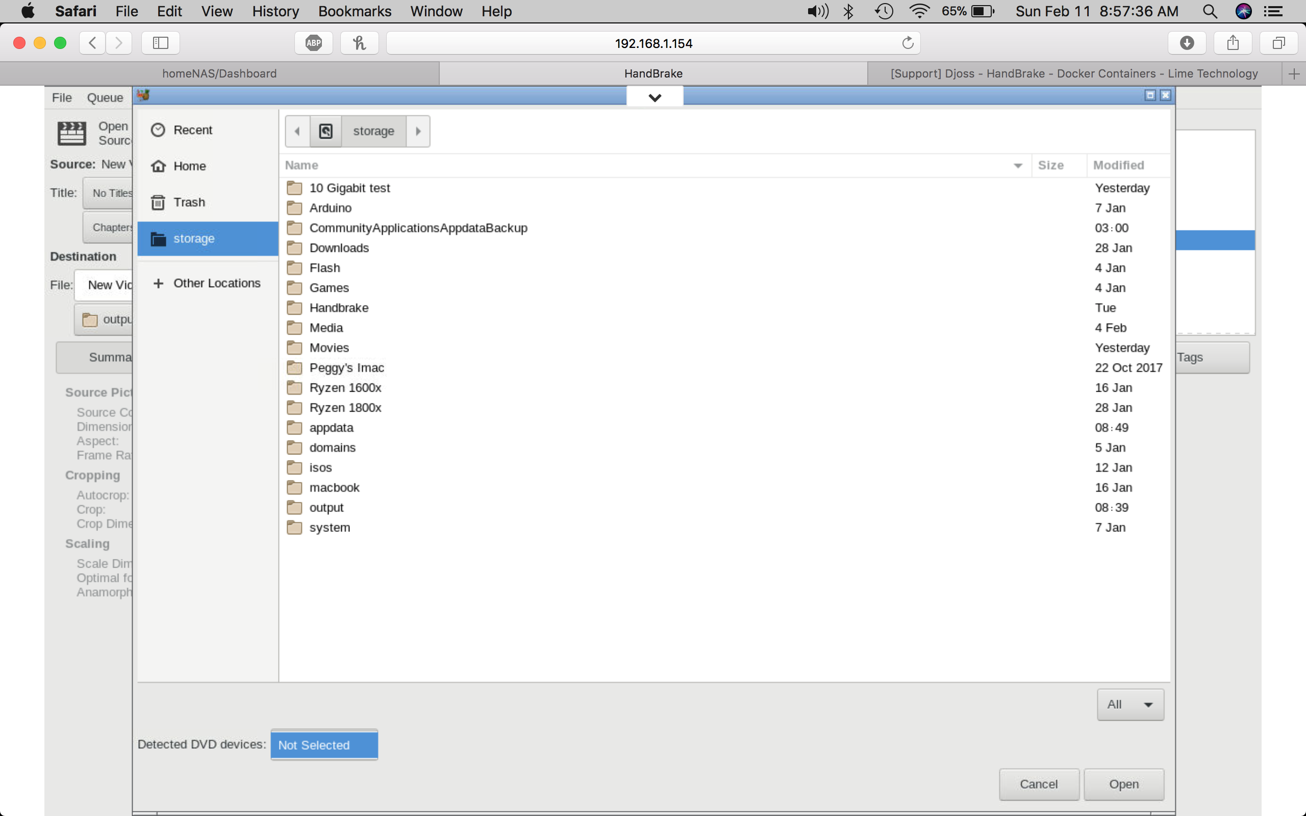

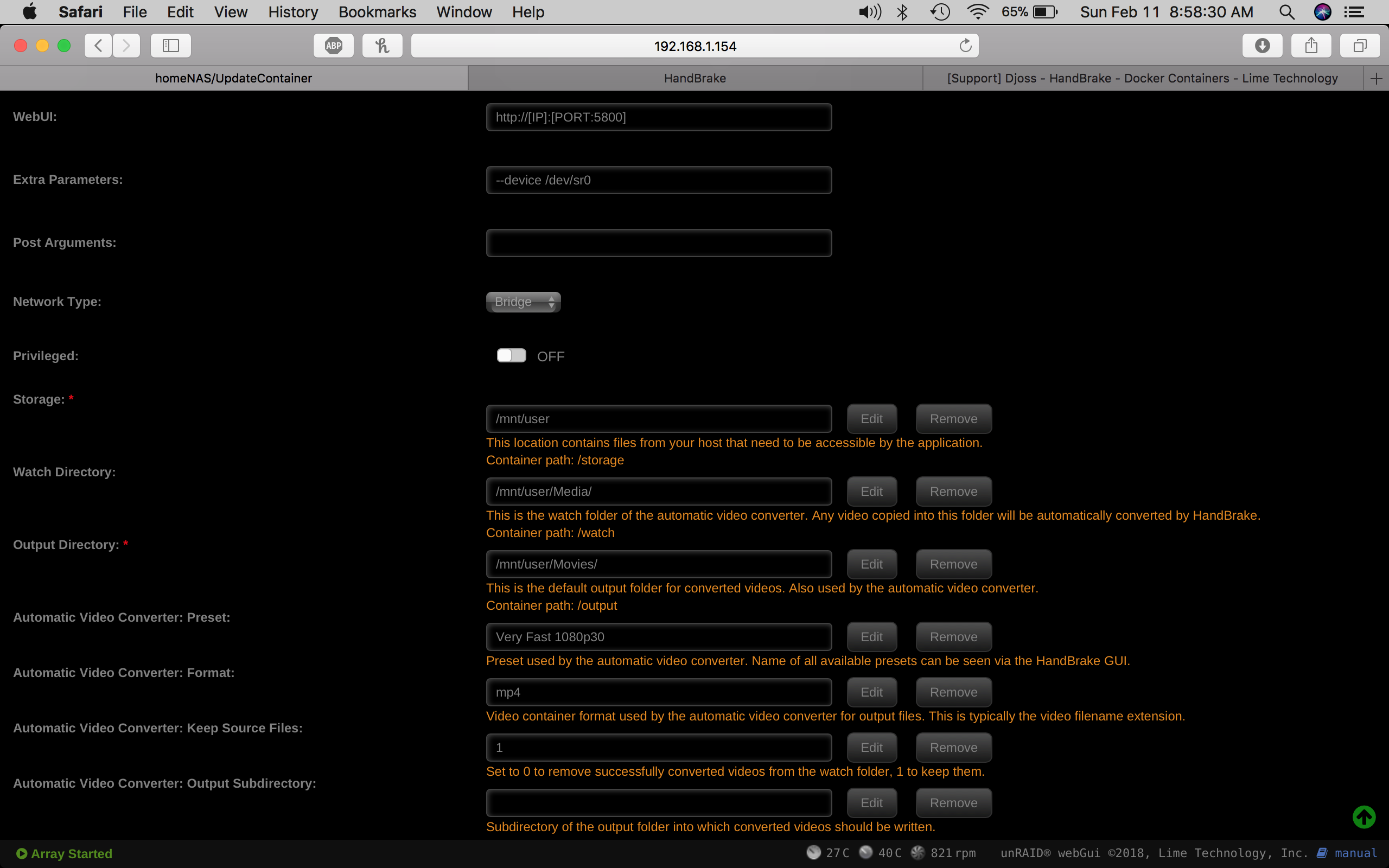

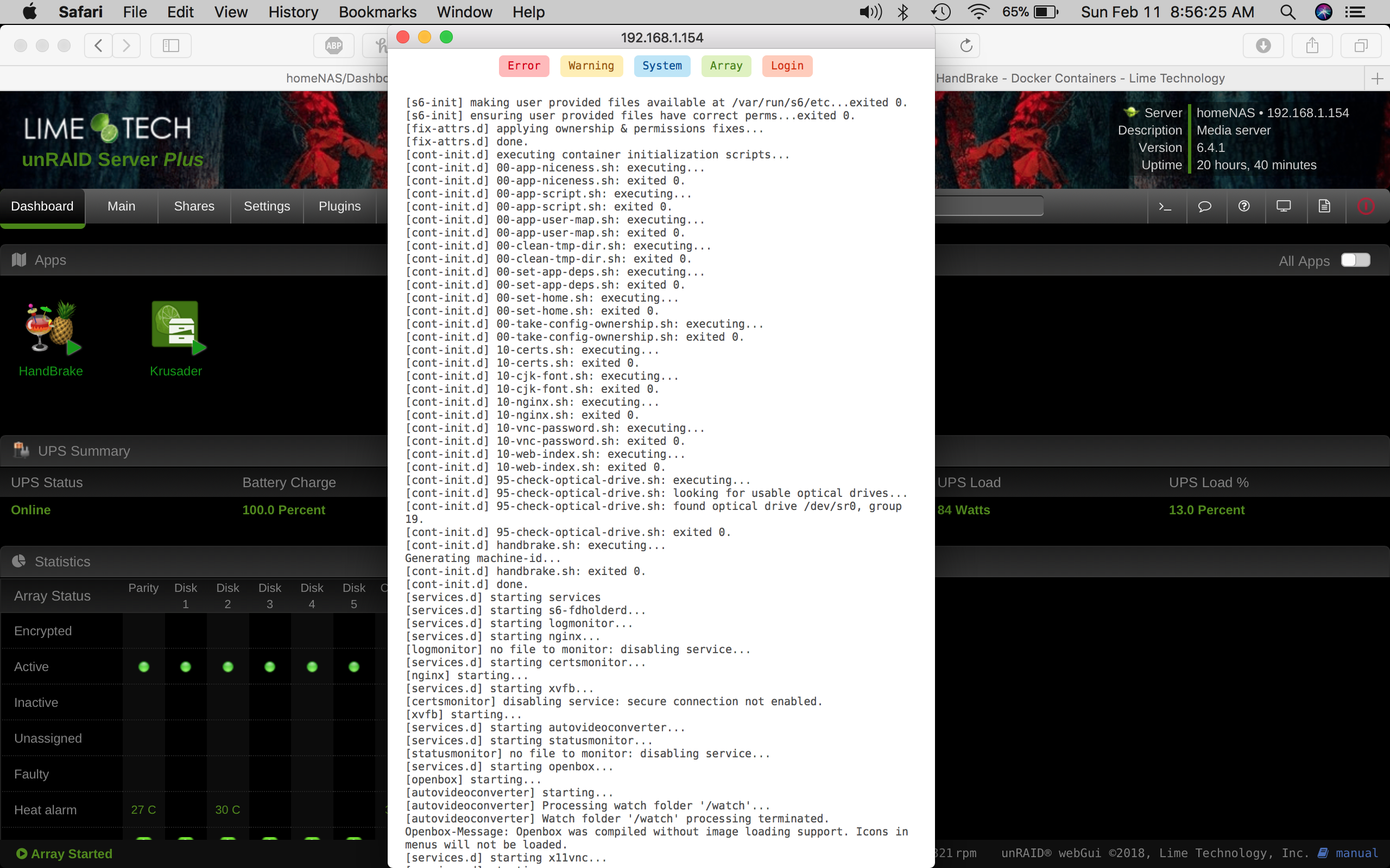

Can someone tell me if they see why handbrake cannot see my dvd drive? (Solved!)

You can access the drive via /dev/sr0.  Ignore the “Detected DVD devices” dropdown.

2 hours ago, mrbilky said:
Sounds reasonable enough where would that be located I searched in Krusader but didn't get a hit?
You need to open /dev/sr0 from the container, i.e. from the HandBrake interface.  In the open window, click the icon on the left of 'storage'.
Excellent finally got something working, thank you for your patience docker is working as advertised!
