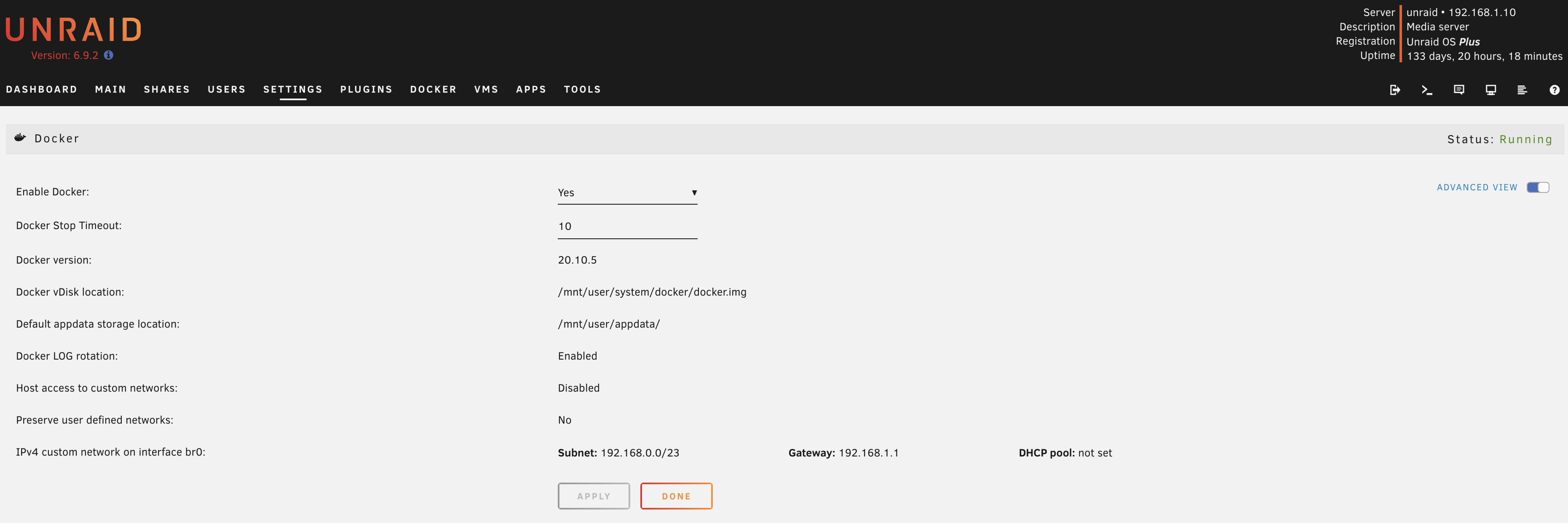

Interesting! I've only been an UnRAID user since 6.9 and yet my logs don't appear to be getting rotated as described. I had one log JSON @ 9GB (my personal docker container registry that seems to log everything including GET requests to syslog).
The problem is that some of the bad log design you're talking about are not at control of the (consumer) of the docker container, but at the control of the author of the container or containerised application. More on that assumed "mission" I referred to in my original post, I don't know if this "mission" extends to masking poor logging within containers/apps in-order to make this as simple as possible for the person consuming the container image. Especially considering that I would say the average UnRAID user might not know how to fix the logging issue. There are plenty of posts here on people trying to identify which container is even the cause of the problem.
My feedback comes from a position of love and not hate. Docker is a complex subject and I appreciate the efforts in "consumerising" it in UnRAID. For me I think I may go back to using docker in a VM for now.
This should be the default settings.  If they're not, then do this.  But, this setting only takes effect on newly installed containers, not already existing ones.  (ie: if this doesn't exist you can either uninstall / reinstall the container (or all containers) or add the applicable line to extra parameters of each container)
There's absolutely nothing Unraid can do to control an app that logs the motion of every particle in the universe.  The log rotation is the best that the OS (or any OS) can do.
The cause of the issue (in most cases) can easily be determined by hitting Container Size on the docker tab.
That's fair. You can't fix all the container & app problems. I think that the log retention is a viable workaround for them.
@Squid not sure where your screenshot is taken from though, but my UnRAID instance looks different to yours, even though I am running 6.9.2. I am missing the "Docker LOG number of files" and "Docker LOG maximum file size" despite setting the view to Advanced View.

It's showing as only 15.2GB but it grew from 70% of 80GB to 99% within 12 minutes at 7am yesterday.
Docker Advanced view - See if there is a ton of orphaned containers, and delete them
No orphaned containers. I'm always in advanced view.
The issue seems twofold:
1. rapid increase in size over the course of just a few minutes
2. massive usage in /var/lib/docker/btrfs
Any ideas how to fix this? From what I read 80 GB is extreme...
