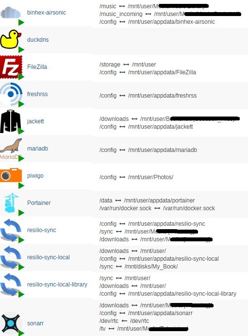

Ok so I need some guidance here... why the heck is my docker image still getting full!?!   I already increased it from the 20gb to 60gb and now I'm getting image full again... currently 99%!
I don't have a ton of containers.. and as far as I can tell by my mappings nothing should be downloaded to the docker itself... everything is mapped to a share.  I 'feel' like it might be something with relilio-sync since those are the newest containers I've added, but still everything is mapped out.
There's nothing that will tell me where the space is being used?
Here's my containers and mappings...
What am I missing??

The only thing that seems to stand out is in Sync.. the default folder location was something like /sync/Resilio Sync or /root/Resilio Sync although neither of those are used, the shared folders are saved on shares..   those seem to be the only paths that aren't mapped to a share....  could that be the issue?
I read the FAQ but except for these everything seems to be mapped correctly.. for the most part nothing else would be downloading enough external data to fill up a multi-gb docker image.
I might delete all the Sync containers and start over anyways, as one of them I seem to have forgotten the GUI password, lol.  I have 3 Sync containers for remote and local sync stuff... wish there was a better way to do it, or could be done through one.

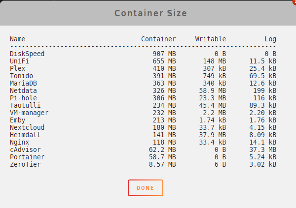

Unraid version 6.6.5 has a function to calculate container sizes and associated usage.
When the "writable" section becomes large, it is usually an indication that a path is set wrong and data is written inside the container.
You can control the "log" file sizes by enabling log rotation in the Docker settings.

Curious if this script https://forums.unraid.net/topic/48707-additional-scripts-for-userscripts-plugin/?page=9&tab=comments#comment-683480 will return different values (run through user scripts)
Just ran it, and got similar results (this is several days newer than the previous screenshot):
Ampache Size: 1.4G Logs: 78.0kB
CUPS Size: 732M Logs: 367.0B
HandBrake Size: 252.7M Logs: 112.6kB
mongo Size: 355M Logs: 20.7kB
nextcloud Size: 186M Logs: 2.7kB
openvpn-as Size: 209M Logs: 13.0kB
pihole Size: 483M Logs: 2.7GB
plex Size: 400M Logs: 4.1kB
RDP-Calibre Size: 1.4G Logs: 3.1MB
Now, the script did take quite a while to churn out the pihole entry...but that could just be counting log size.  I really suspect that pihole is the culprit, but I have no idea where the extra storage usage could be.
