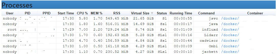

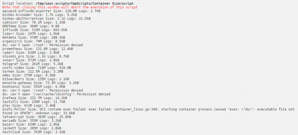

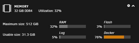

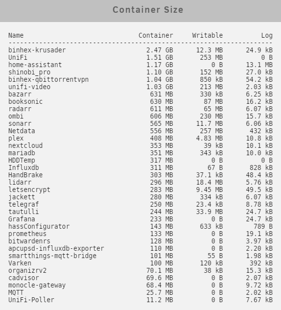

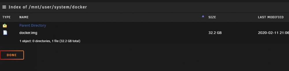

My docker image has also been increasing for a while.  This is what I am seeing based on the prior thread suggestions:
root@baconator:~# du -h -d 1 /var/lib/docker/
1.2M    /var/lib/docker/containerd
93M     /var/lib/docker/containers
0       /var/lib/docker/plugins
99G     /var/lib/docker/btrfs
42M     /var/lib/docker/image
120M    /var/lib/docker/volumes
0       /var/lib/docker/trust
208K    /var/lib/docker/network
0       /var/lib/docker/swarm
16K     /var/lib/docker/builder
56K     /var/lib/docker/buildkit
1.4M    /var/lib/docker/unraid
0       /var/lib/docker/tmp
0       /var/lib/docker/runtimes
99GB docker file??  lol

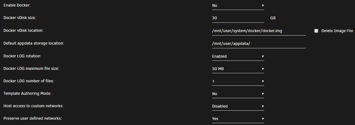

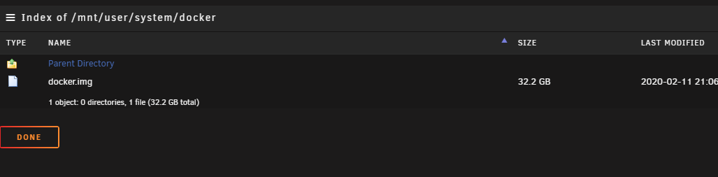

My docker is supposed to be 30GB (see below)

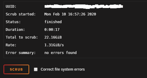

I also performed a scrub as well.

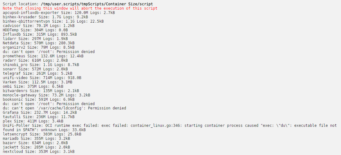

I dont think it is log files:
Just like everyone else, nothing in these show anything anywhere near 30GB.
I have tried to truncate logs and that didnt do much either by using the following:
truncate -s 0 /var/lib/docker/containers/*/*-json.log
I did see this in Cadvisor though:
Any ideas?  This is highly frustrating.  Thanks for any help.
Edited by danktankk
added new data

Try this user script https://forums.unraid.net/topic/48707-additional-scripts-for-userscripts-plugin/page/8/?tab=comments#comment-682421  It calculates the sizes slightly different than the Container Size button.  Is there a significant difference?  Note that the script can only calculate sizes for running containers.
Hey,
Thanks for the reply.  I dont see anything here that would indicate an issue either.  This is what I got from running the script:
Edited by danktankk

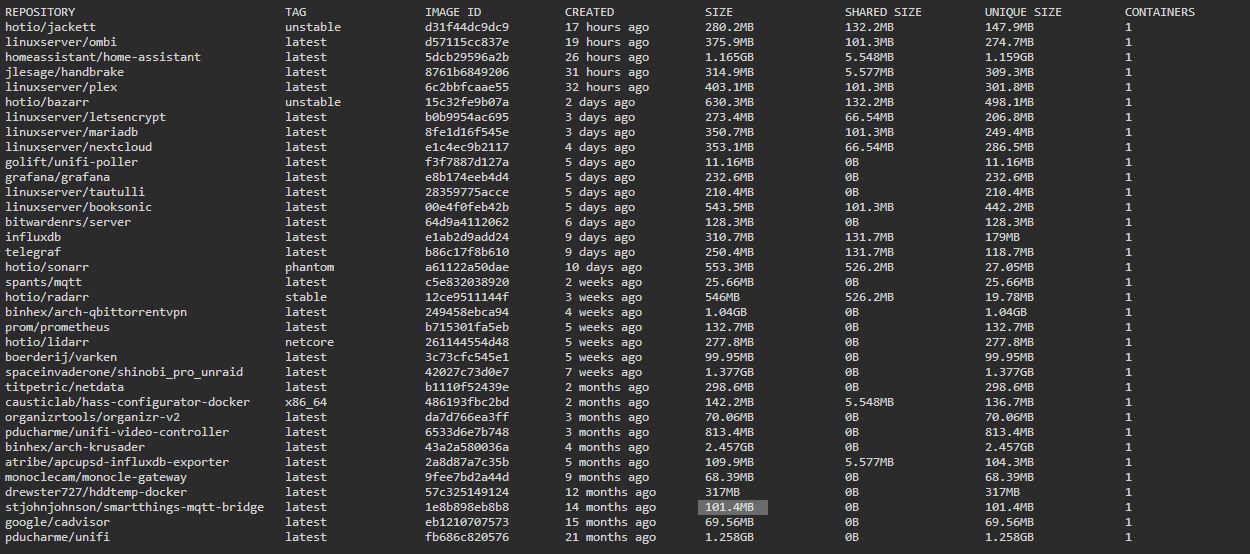

du command goes across filesystem for sure
I've tried this one too and mine returns a 74G /var/lib/docker/btrfs, my docker image having 40G.
However if I insert -x argument it returns 0 for that volume. I'm sure it calculates some volume mappings or something.
So usually I use
root@Tower:~# docker system df
TYPE                TOTAL               ACTIVE              SIZE                RECLAIMABLE
Images              28                  28                  11.57GB             784.9MB (6%)
Containers          28                  16                  1.744GB             372.3MB (21%)
Local Volumes       11                  1                   39.68MB             0B (0%)
Build Cache         0                   0                   0B                  0B
or
root@Tower:~# df -h | grep /dev/loop2
/dev/loop2       40G   15G   25G  38% /var/lib/docker

Try this:  go to the Shares tab.  Click on the folder icon next to the system share.  Now click on the folder for Docker.  What size does it report on that page for the docker image size?
Also, when you scrubbed your container, did you notice the amount scrubbed was only 22GiB?
If you're not familiar with how Docker, volume mappings, thin provisioning, etc. work, the du command can certainly confuse you.

Thank you for the reply!  This is the amount of space it is currently reporting:
All containeras added up is 15.6GB or so:
however, I am still seeing this usage and getting notifications often:
If the amount scrubbed is 22.16GB, it does make sense that it would report, and does report 75-80% usage.
Is there any reason for this discrepancy (15.6GB vs 22.1GB you can think of?

There are probably some additional files inside the docker.img or perhaps images that aren't active in use but are consuming a tiny bit of storage.  I really wouldn't be concerned.
Fair enough.  Ill increase the docker size and move on.  Thank you!
