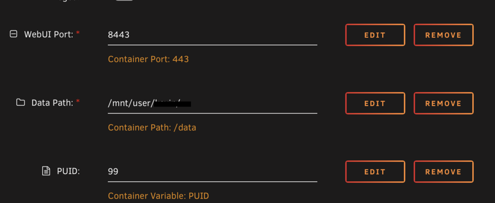

Super great work getting it all working in one box. Two notes.
On 6/3/2017 at 1:16 PM, dlandon said:
To install the docker from scratch:
  • Install docker and then go to the WebUI.
  • Enter an administration user and password.
  • Change the data folder to /data.
  • Because the database is built into the container, the database host is localhost.
  • The database user and the database itself are both 'owncloud'.
  • If you do not change the default DB_PASS variable, the default database password is 'owncloud'.
  • Once in the ownCloud WebUI, go to 'Settings->General' and click the 'Cron' method for the cron.php task.  A cron to perform this is built into the docker.
  • If you use your own certificate keys name them cert.key and cert.crt, and place them in config/keys folder.
Respectfully; I strongly suggest putting this in the Template's "Overview" section for the Container Template itself. None of this is intuitive or safely assumed. There's no limit on how much text you can put there, and you already have sections for configuration -and- notes there, which are also required to set up the container -- but not listed in the Install text above. Putting this information all together and in the Overview would remove "go to the Support forum for more information" from the unlisted requirements to using this container.
Also, regarding "Change the data folder to /data" -- why not just bind the user's data volume to `/config/www/owncloud/data` (which is OwnCloud's actual default) instead? If the template default is to bind to `/config/www/owncloud/data` instead of `/data` new users don't need to change the data folder, it will simply "just work" without that step. The user won't see any difference. Presently, if the user doesn't know to do this or misses/misconfigures this step, their database gets wiped when the container updates and they just suddenly lose stuff.
