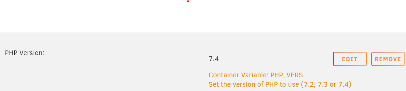

so i just installed this own cloud  trying it out didnt care for the nextcloud  as it doesnt save my files on the array in a folder.. so trying out this one....  but i dont know how to update php???
i get this error
This version of ownCloud requires at least PHP 7.4.0
You are currently running PHP 7.2.34-38+ubuntu20.04.1+deb.sury.org+1. Please update your PHP version.
i didnt know i have php installed
i get this error

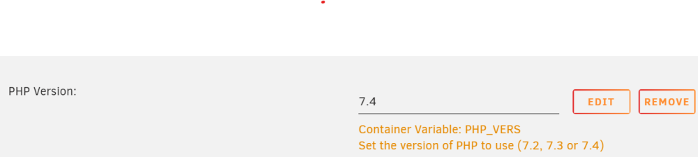

Edit the ownCloud docker template and change the PHP Version setting:

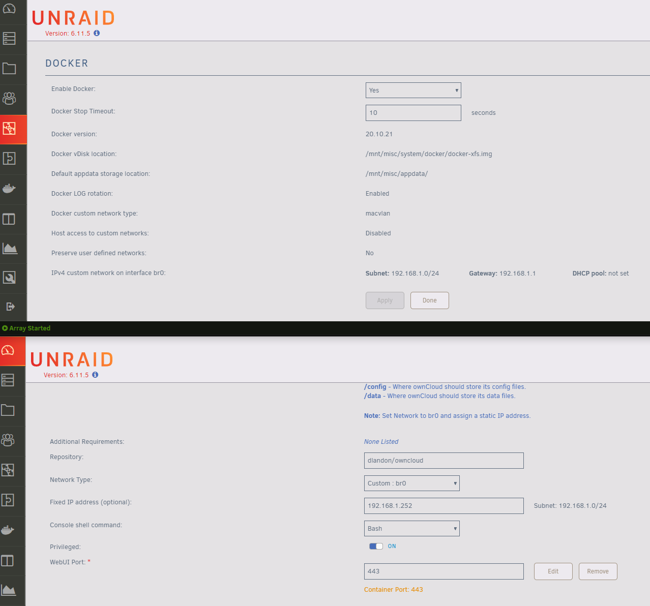

I just installed this today, and if I have it configured to use br0 as the network, and a fixed/static IP, I'm seeing lots of errors in the log:
Err:1 http://archive.ubuntu.com/ubuntu focal/main amd64 bsdmainutils amd64 11.1.2ubuntu3
  Temporary failure resolving 'archive.ubuntu.com'
Err:2 http://ppa.launchpad.net/ondrej/php/ubuntu focal/main amd64 libpcre2-16-0 amd64 10.40-1+ubuntu20.04.1+deb.sury.org+1
  Temporary failure resolving 'ppa.launchpad.net'
Err:3 http://ppa.launchpad.net/ondrej/php/ubuntu focal/main amd64 libpcre2-32-0 amd64 10.40-1+ubuntu20.04.1+deb.sury.org+1
Err:4 http://archive.ubuntu.com/ubuntu focal/main amd64 libuchardet0 amd64 0.0.6-3build1
Err:5 http://ppa.launchpad.net/ondrej/php/ubuntu focal/main amd64 libpcre2-posix3 amd64 10.40-1+ubuntu20.04.1+deb.sury.org+1
Err:6 http://archive.ubuntu.com/ubuntu focal/main amd64 groff-base amd64 1.22.4-4build1
Err:7 http://ppa.launchpad.net/ondrej/php/ubuntu focal/main amd64 libpcre2-dev amd64 10.40-1+ubuntu20.04.1+deb.sury.org+1
Err:8 http://archive.ubuntu.com/ubuntu focal/main amd64 libpipeline1 amd64 1.5.2-2build1
If I switch to use the bridge network and set a custom port number, then it goes through the whole setup process and I can land at the ownCloud install screen in the browser.  Soon as I restart the container on br0, it tries to go through the whole setup process again with the same set of errors.  What gives?  What am I doing wrong, what should I look at?
For further information... looking at my Unifi router page, I can see the docker for ownCloud, or what I believe it to be, based on the MAC address - but its not assigning itself an IP Address, even though I have that filled in on the template.  No IP == no connectivity... so why isn't the IP passing through?
I have mine set with 'Custom: br0' network and a fixed IP address, so I know it can be done.  It appears there is an issue with your network.  Check your network setting in Settings->Docker.  Be sure the 'IPv4 custom network on interface br0:' is set properly and your ownCloud IP address is set in that range.
I'm assuming that's gotta be it... but here's my settings:
I've got another docker (pihole) also running on the br0 network, and that doesn't seem to have any issues. It's configured for 192.168.1.2 as its IP -- and no, there's no other device on my network at 192.168.1.252 at this time. I also tried .15 for kicks as well.
ownCloud uses port 443 for https access.  Unraid also uses port 443 as the default.  Be sure they don't conflict and that port 443 is passed to ownCloud through your router.
Unsure what exactly you're getting at here. If ownCloud is on its own IP address, then it shouldn't matter if unraid does use 443 or not. It's a different IP than my Unraid server listens on.
Just in case, I updated the docker config to map port 8443 (unused by anything else on Unraid at all) into the ownCloud docker. Still getting the same errors.
I also spun up an instance of Nextcloud using the same br0 network, on 192.168.1.5, and it works perfectly fine. Really stumped here.

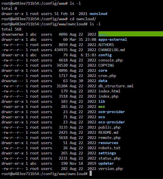

Hi all, after upgrading unraid to version 6.12.3 2023-07-14 I'm no longer able to upload, delete or change files. No matter if I try it by web ui or mobile apps. Last log entry is from 2023-08-02T18:36:13+00:00. That means logging stopped from that point.
By the attampt to upload a file via Android app I can see a push message telling me it is not possible to upload due to insufficient rights. I checked with ls -l /config ->
But most directories and files underneath have root:users. Only a few have abc:users
Is that correct or has it abc:users as well?
BR,
Sascha
Edited by bonox
