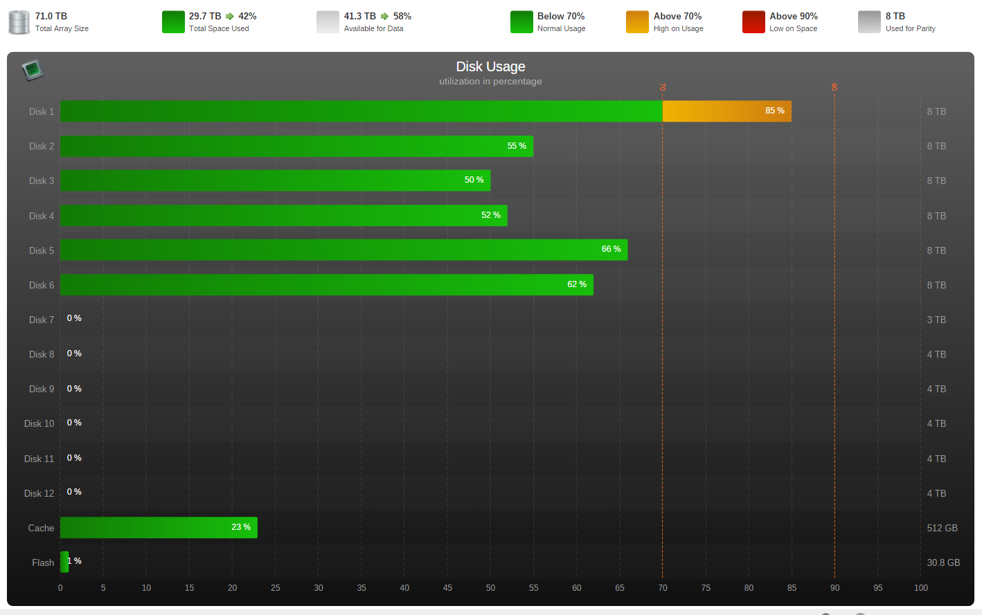

My drives have been filling up to 50% and then going to the next drive which is fine. When the server filled up the last 8TB hard drive it went back to the first 8TB and started filling it up and ignoring the smaller hard drives. Below is a screenshot of my array looks like:

High-water is the default allocation method (and for a good reason). Take a look at one of your user shares and turn on Help to see if you can understand what it does.

So the way I understand it the reason it went back to the 8TB drives is because it looks the amount of data rather than the percentage free? If so that makes sense. I checked before posting to make sure the two main shares I have been using are both high water and they are set to high water.

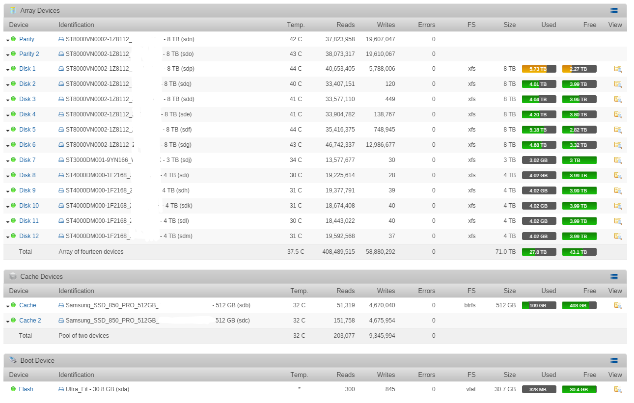

Also I posted a screenshot of the stats page for disk usage. When will the newer drives start to get used by unRAID?
When writing to a user share, whether and when a disk gets written to depends on that user share's setting, as already mentioned. Like many things, simple questions don't have simple answers. This isn't because the answers are too hard, it is rather because the questions are too simple.

Highwater in a nutshell with differing size drives.
First 8TB fills to 4TB, then system moves to next drive until all 8TB's are filled to 4TB.
Then the process starts over again.  All 8TB will fill to 2TB free, and then the system will move on (But the 3TB will fill up to 2TB free, and the 4 TB will fill to 2TB free)
Then the 8TB will fill to 1TB (and all the remaining drives will also fill to 1TB free)
Net result is that everyone of your 8TB's will have 2TB free before the system even touches the 3TB or the 4's.  But, as Trurl stated, the are complications on this depending upon share's split levels, etc.
