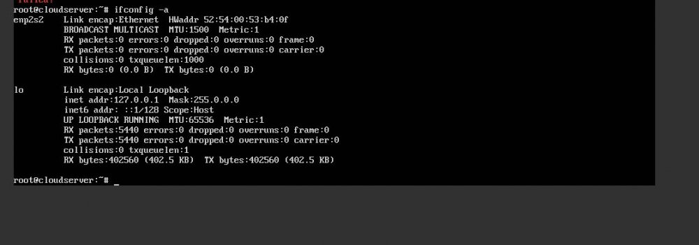

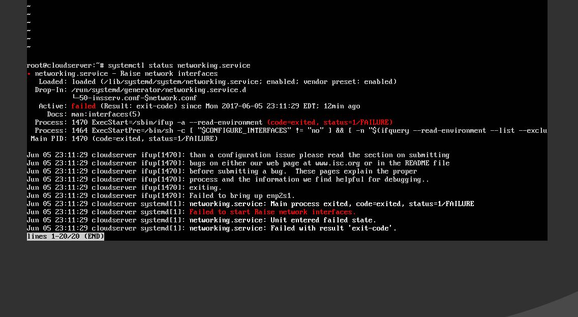

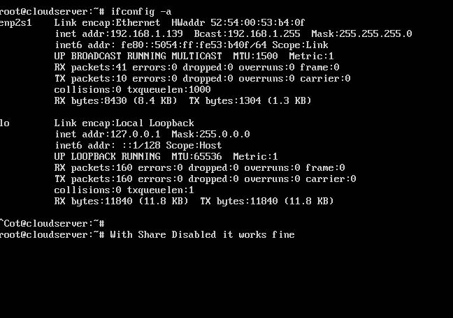

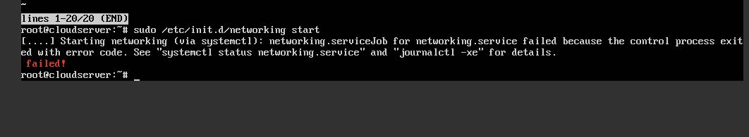

June 6, 20179 yr I have an Ubuntu server VM that I want to mount a share into. VM config -> advanced-> unRAID share (add path) -> unRAID mount tag (add tag) -> start server -> fails to start network service at boot recommends running systemctl status networking.service, screen shots below. It sees the interface but won't start the service. However if I remove the share it works fine.

June 7, 20179 yr Author For anyone wondering, it appears to work fine in Debian. Probably just an Ubuntu issue, I was running Ubuntu 16.04.2 server, might have been fixed in a newer version but I'm just going to switch to Debian since it's pretty much the same. Thanks for ruling out an unRaid issue Jon.
August 10, 20179 yr I just stumbled across this post while looking to see where the UNRAID share is mounted within the VM I was having the same issue with 17.04 The following fixed this issue for me https://stackoverflow.com/questions/41609676/failed-to-start-raise-network-interfaces ip link example: lo , enp0s8 add following lines in /etc/network/interfaces auto enp0s8 iface enp0s8 inet dhcp restart your VM.

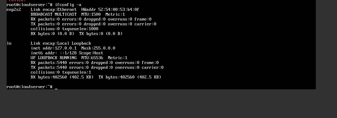

August 31, 20179 yr Hey guys, I had this same issue tonight when building an Ubuntu 16.04.01 Server VM. OS is installed fine and all seems well until I added my Unraid shares and rebooted. Suddenly, no network. Was seeing "Device not found" messages when trying to start the networking service. I did some digging and noticed that my nic used to be labeled enp2s2. After the shares were added and rebooted, I ran ip link only to find my nic is now labled enp2s6. After looking at the XML, I think it makes sense why. Below is a bit of the XML for this VM, AFTER I added the shares. Seems like the shares take precedence in the config file somehow and push the nic down to another slot. slot='0x06' in the config file apparently corresponds to enp2s6 nic label. To solve the problem, I was able to change the nic label in the /etc/network/interfaces config file and reboot. All is well again. Hopefully, that makes sense and it helps someone else. <filesystem type='mount' accessmode='passthrough'> <source dir='/mnt/user/media/Movies/'/> <target dir='Movies'/> <alias name='fs0'/> <address type='pci' domain='0x0000' bus='0x02' slot='0x01' function='0x0'/> </filesystem> <filesystem type='mount' accessmode='passthrough'> <source dir='/mnt/user/media/TV/'/> <target dir='TV'/> <alias name='fs1'/> <address type='pci' domain='0x0000' bus='0x02' slot='0x02' function='0x0'/> </filesystem> <filesystem type='mount' accessmode='passthrough'> <source dir='/mnt/user/media/Kid Movies/'/> <target dir='KidMovies'/> <alias name='fs2'/> <address type='pci' domain='0x0000' bus='0x02' slot='0x03' function='0x0'/> </filesystem> <filesystem type='mount' accessmode='passthrough'> <source dir='/mnt/user/media/Kid TV/'/> <target dir='KidTV'/> <alias name='fs3'/> <address type='pci' domain='0x0000' bus='0x02' slot='0x04' function='0x0'/> </filesystem> <filesystem type='mount' accessmode='passthrough'> <source dir='/mnt/user/media/Music/'/> <target dir='Music'/> <alias name='fs4'/> <address type='pci' domain='0x0000' bus='0x02' slot='0x05' function='0x0'/> </filesystem> <interface type='bridge'> <mac address='52:54:00:c7:28:ff'/> <source bridge='br0'/> <target dev='vnet0'/> <model type='virtio'/> <alias name='net0'/> <address type='pci' domain='0x0000' bus='0x02' slot='0x06' function='0x0'/> </interface>
September 30, 20179 yr @alowishes, Thanks for your link. That is definitely part of the solution. @ccmpbll, You are on to something. Adding an unraid share changes the ip link and thus necessitates editing /etc/network/interfaces to restore network functionality. However, the unraid share is still not mounted to the VM for me on Ubuntu 17.04. Does it work for you? I can't get this to work by editing the VM XML. Instead, I edited /etc/fstab in the VM to mount the UR share to /media/unraid Edited September 30, 20179 yr by kamhighway
