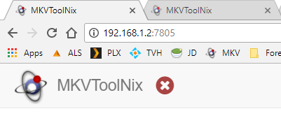

hi, the issue with 1006 in browser still happen all the time just as note, always have to clear browser cache for this docker.
may an idea how to solve this ?
websock.js:292 WebSocket connection to 'ws://192.168.1.2:7805/websockify' failed: Error during WebSocket handshake: Unexpected response code: 502
open @ websock.js:292
_connect @ rfb.js:346
_updateState @ rfb.js:488
connect @ rfb.js:243
start @ ui.js:65
(anonymous) @ (index):64
j @ jquery.min.js?v=75e3e79854:2
k @ jquery.min.js?v=75e3e79854:2
util.js:218 WebSocket on-close event
Util.Warn @ util.js:218
(anonymous) @ rfb.js:193
(anonymous) @ websock.js:320
util.js:220  Msg: Server disconnected (code: 1006)
13 minutes ago, Djoss said:
Which browser are you using?  Which version and OS?
issue is still only in chrome, already changed from stable to beta chrome, same behavior, works on start when chrome is fresh, also works when chrome is completely cleared,
sometimes works when i only clear data from current site (F12 and hold refresh) ...
on vnc, edge, and guacamole (same chrome) its always good ... only direct web access on this container ending up here with this.
OS, win 10 x64, chrome also x64
What is the exact Chrome version?
When you start and it's working, what you do to make it fails?

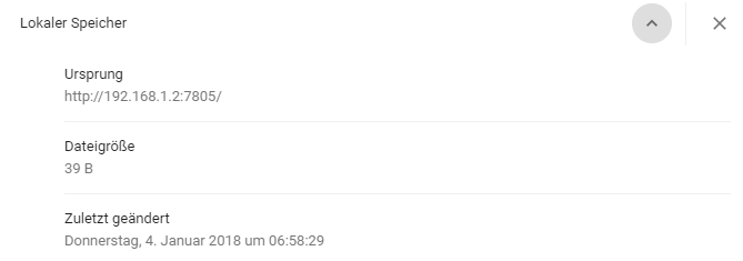

Next time you reproduce the issue, can you provide content of the cookies using Chrome developer tools?

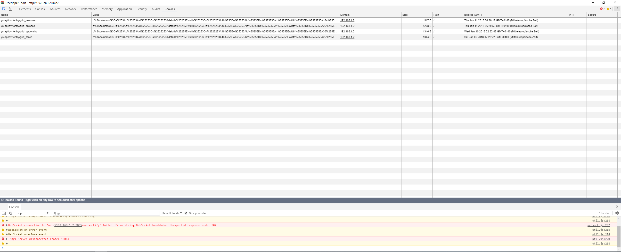

it worked a few days and now it aint working anymore for a few days ;) even after reboots and so on.
may a hint what you could need ? no idea how to show content of the cookie ...
in dev console from chrome, some websocket error ... but when i now go ahead and use hostname instead ip it works ...
i guess may cause i have alot 192.168.1.2:xxxx adresses connecting to docker from this mashine, still should work but thats may the reason ...
cause using apache guacamole always works, vnc viewer always works, just as note ... i really have no clue and can hardly say "THEN" it is happening,
always by time after ...
image.png.7dd0e74c2c77b68e7ba69c72edf2d69b.pngimage.png.786608bee825d6cacdc9a5633e7ce00f.png

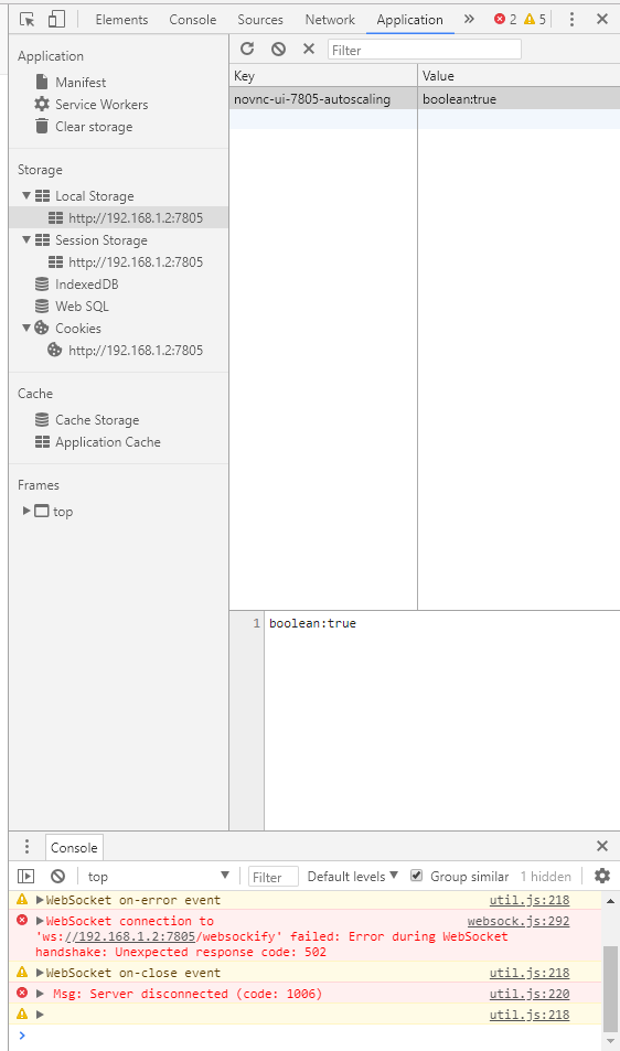

Starting UI...
util.js:218  Msg: noVNC ready: native WebSockets, canvas rendering
util.js:218
util.js:218 WebSocket on-error event
Util.Error @ util.js:220
util.js:218
Click the "Application" tab of developer tools.  You should then see multiple sections for different storage types.  Look at each of them...
