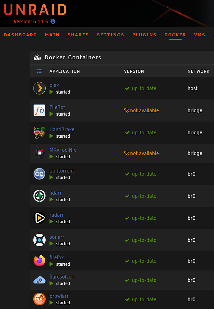

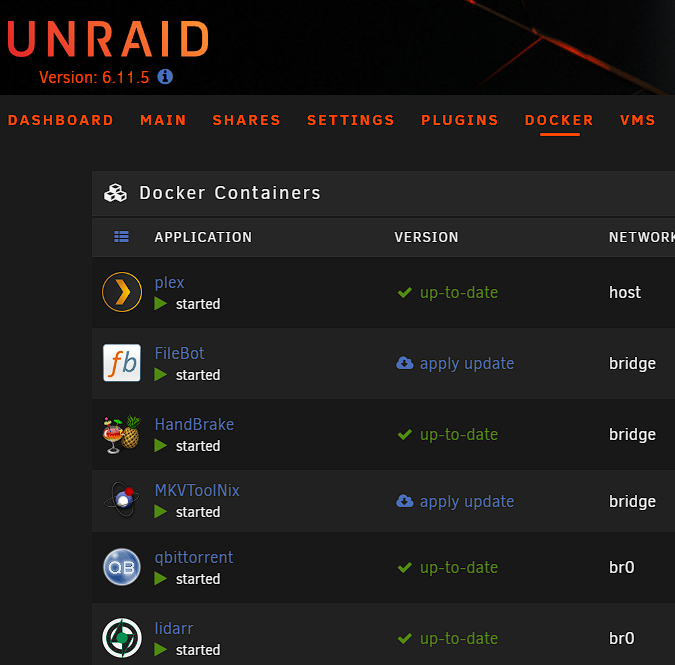

@Djoss has anything changed recently with your docker images? I run Handbrake, FileBot and MKVToolNix and noticed recently that both Filebot and MKVToolNix both can't seem to see any updates, however Handbrake works fine? This has been for about a week now.
These are the Docker URL's and repo's I have set:
Repo: jlesage/filebot:latest
URL: https://hub.docker.com/r/jlesage/filebot/
Repo: jlesage/mkvtoolnix:latest
URL: https://hub.docker.com/r/jlesage/mkvtoolnix/
Repo: jlesage/handbrake:latest
URL: https://hub.docker.com/r/jlesage/handbrake/
Edited by cybrnook
This is an unRAID bug.  See the following thread:
You can install a plugin to fix the issue until the next unRAID version.
