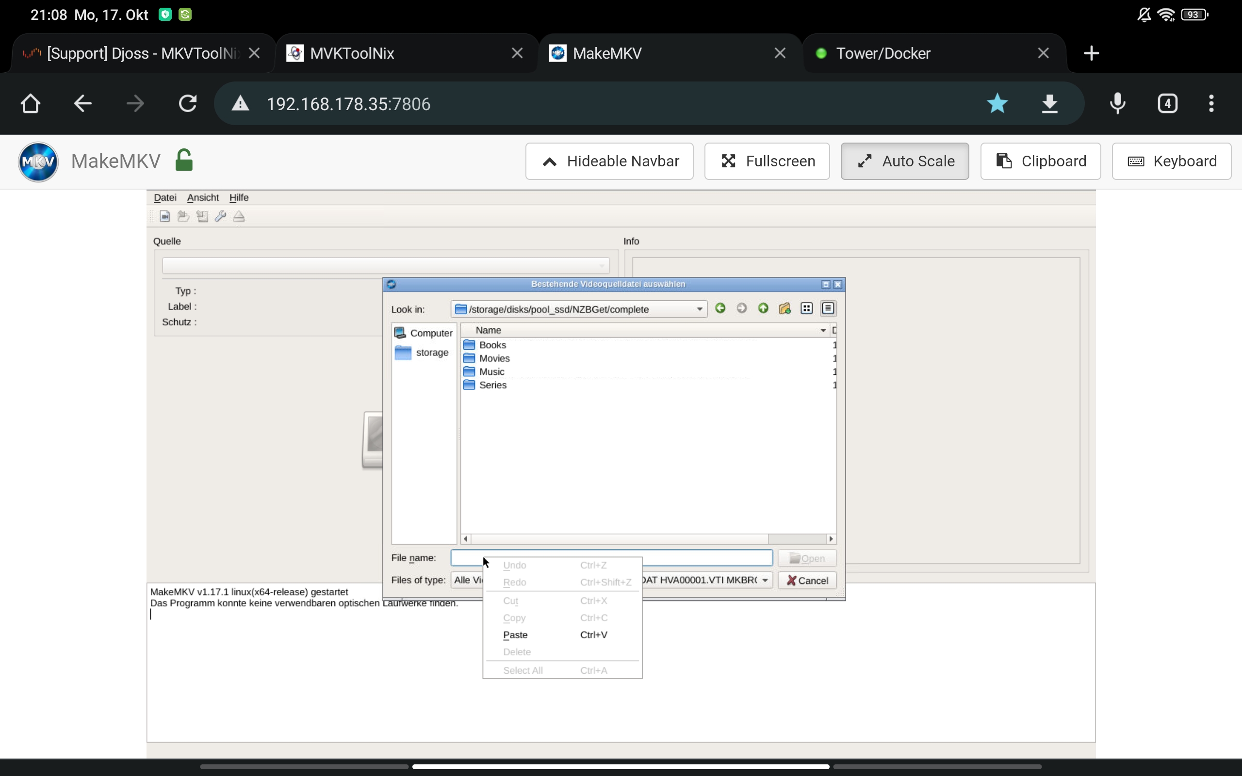

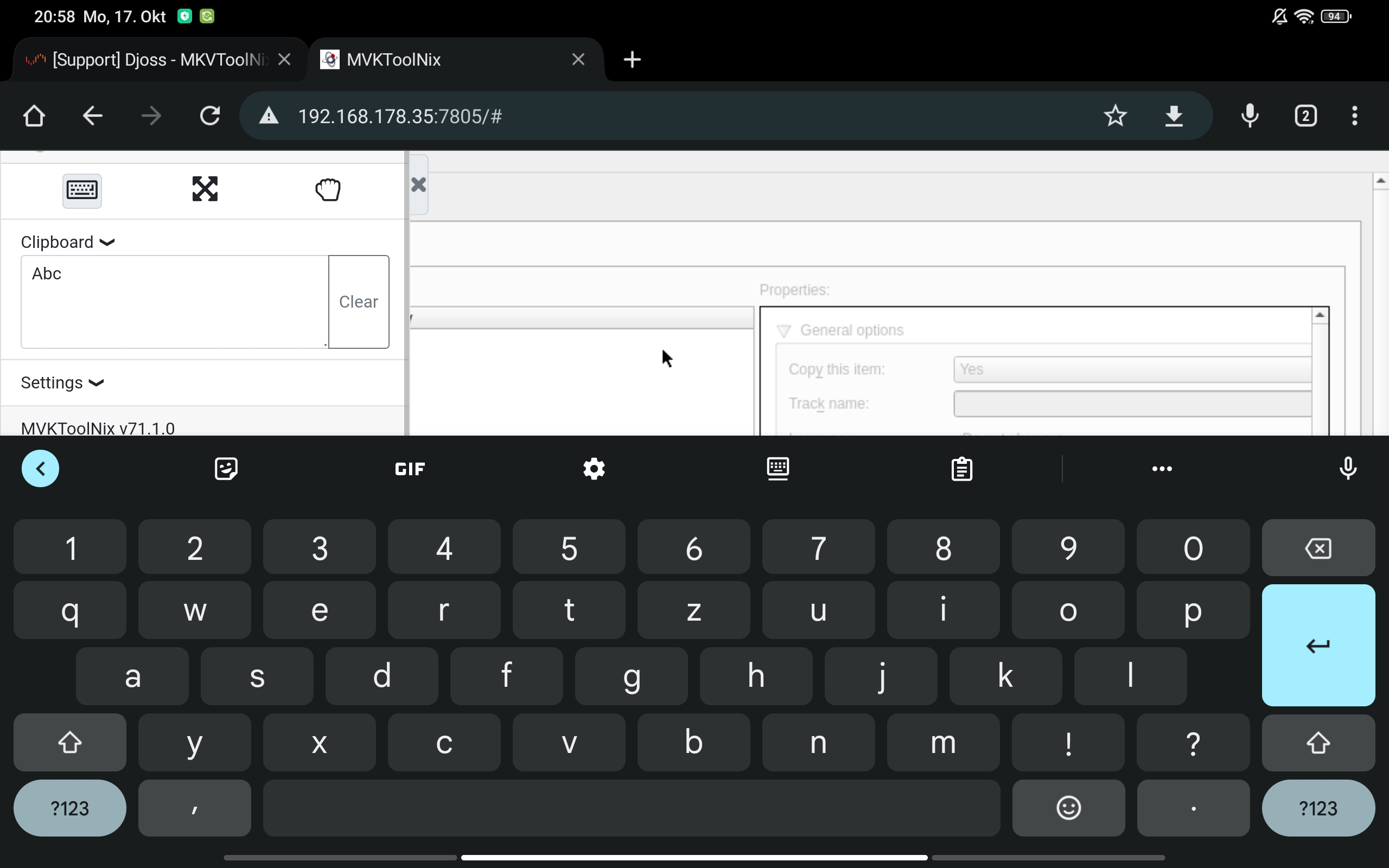

Re. Clipboard on Android tablet: How do I get clipboard value into an entryfield without the dialog that appeared in previous releases? I can enter something into the new clipboard box. What to do now? Look at the screenshot to get an idea. Not much space left with the new menu.
Screenshot_2022-10-17-20-58-06-971_com.android.chrome.thumb.jpg.655cc2b99d616562235658e761ebf09c.jpg

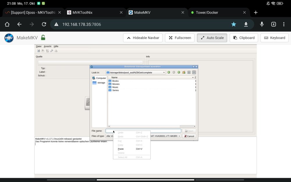

In old GUI there was a copy/paste dialog. BTW, you can see the old GUI fitting completely on screen:
Screenshot_2022-10-17-21-08-26-412_com.android.chrome.thumb.jpg.b63a5849901f80fe172425cb57ffb370.jpg

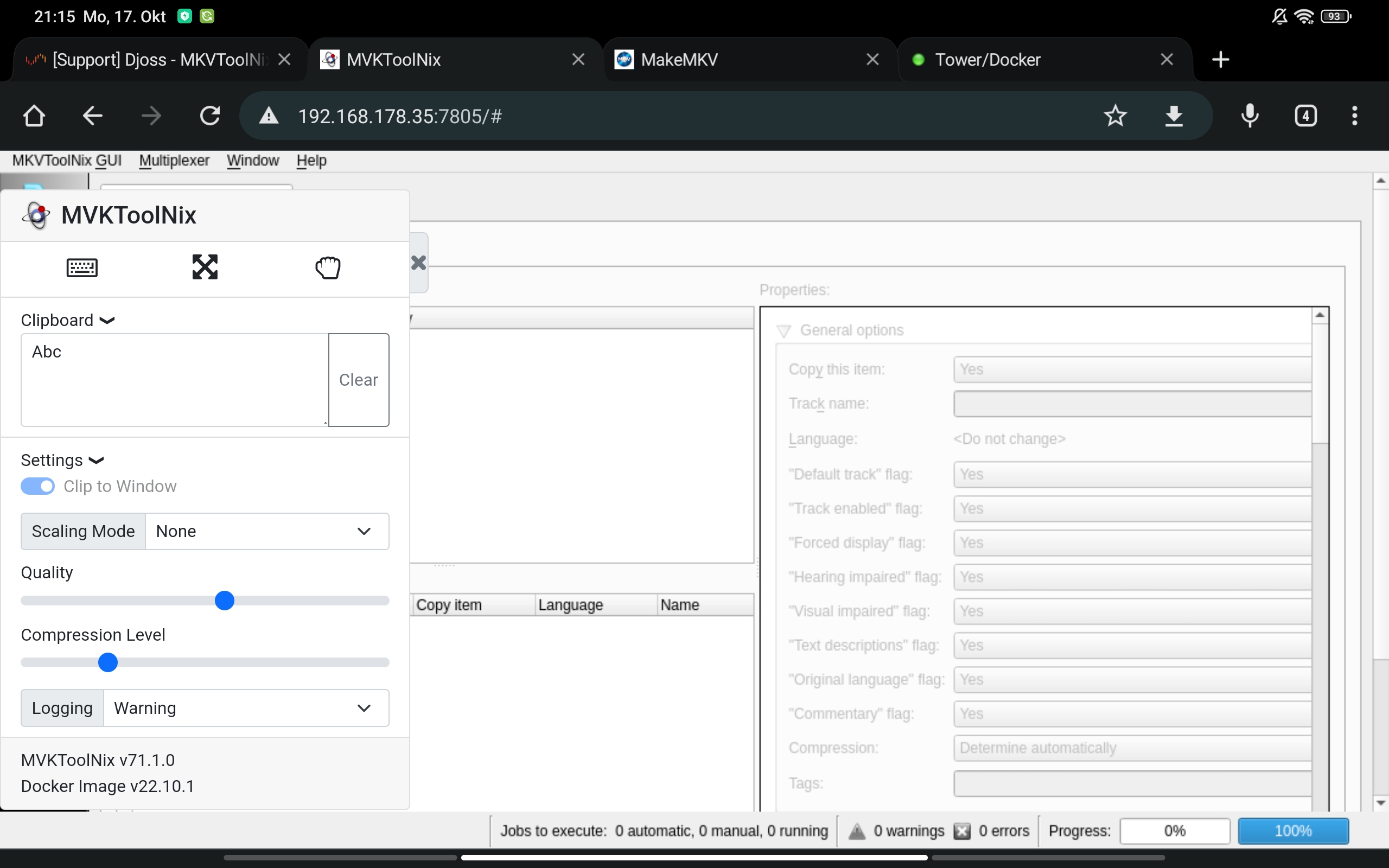

The last screenshot for now shows the required scrollbar now. No scaling option changes that:
Screenshot_2022-10-17-21-15-01-352_com.android.chrome.thumb.jpg.2c9a90c4a8ccafe4902605aa25bb7874.jpg
