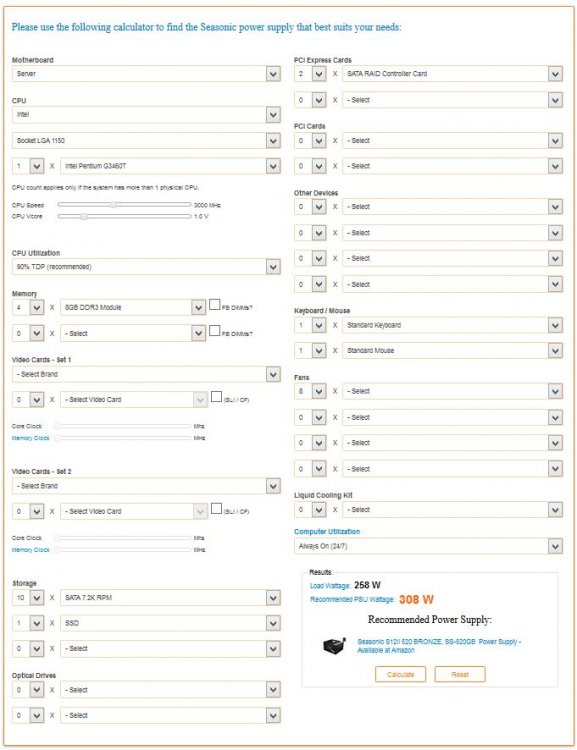

July 12, 20179 yr Author For 10 x seagate archive 8TB and the G4600 how much watt do i want? Maybe later i will add a sata controller and 4 more disks. I just saw that seagates needs 7,5w in full load, so 75w to 105w for the disks..

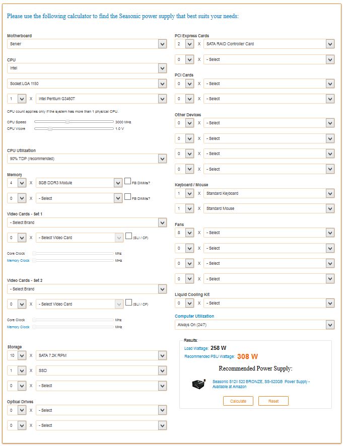

July 12, 20179 yr Look at the attachment. I did a quick sizing. It came back with 308 watts. I'd not go quite that low so you have room to grow. Maybe ~400watts might be good. But I tend to over-engineer. (This is without a video card) Here is a link to that sizer if you want to play. https://seasonic.com/psu-calculator/

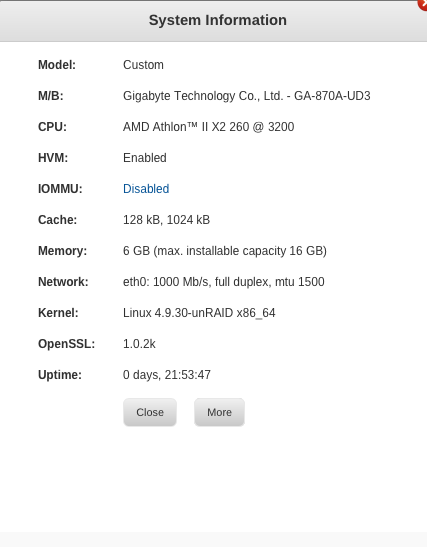

July 13, 20179 yr Author Right now i have set up unRAID in the following hardware and i transfer my data to the pool. I didnt notice any delays on the response. Transfer speeds vary for 80-100mb/s when i copy files to the first drive, now in the second drive the speeds was 30-50mb/s i had 1 parity from the start. I move files and the drives from xpenology, i copy them to unRAID, then put the drives that i empty to unRAID and preclear them. preclear for a Seagate archive 8TB could take 40-45hours. When i will get the new faster built for my unRAID, the preclear time (for the same model of disk) will be shorter? and also the parity check? i don't think i will see any difference for the transfer speeds.. when i preclear a new disk, is it a good idea, for all disks and the parity, to have them Spin down delay: at 15 minutes? Edited July 13, 20179 yr by volume
