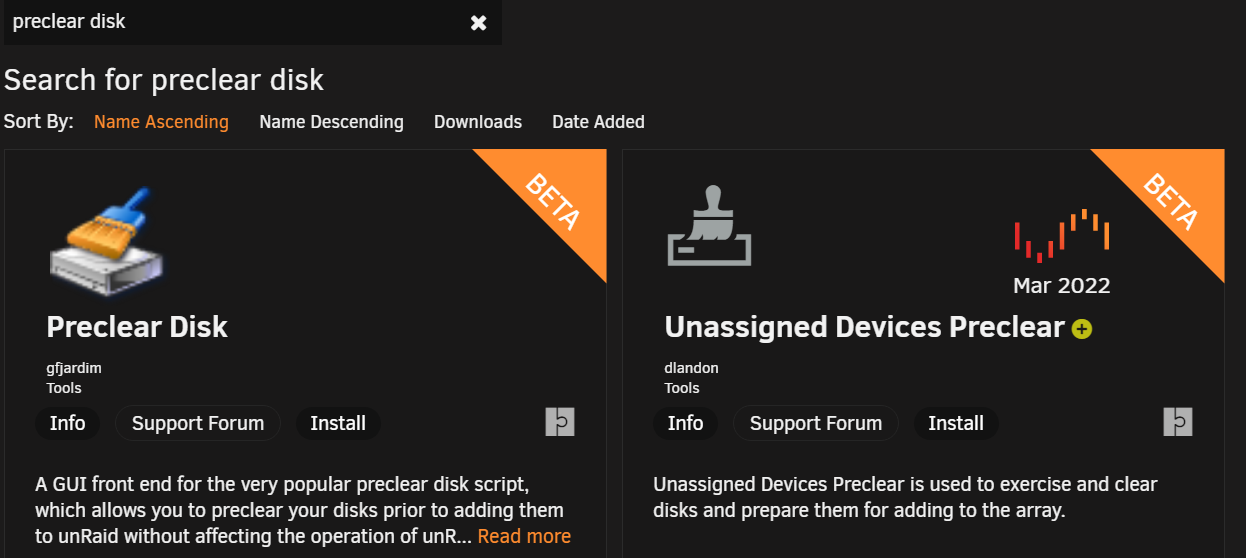

@Joe L.'s preclear script has not been maintained for years.   You should be using either the Plugin or the Docker.  You can find them in the Unraid App store--- the Apps tab of the GUI.  (Personally, I use the preclear Docker BUT I am not afraid of the command line.)
Ah I see
Me and my old school methods (haha)
I see there is an unassigned devices preclear too, that's pretty cool, I could toss the disk in my dock and preclear that way... hm may give that a try?
