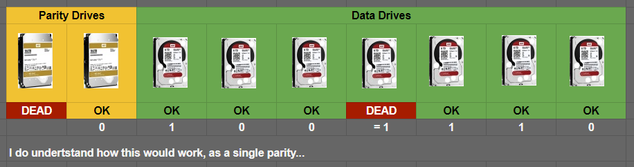

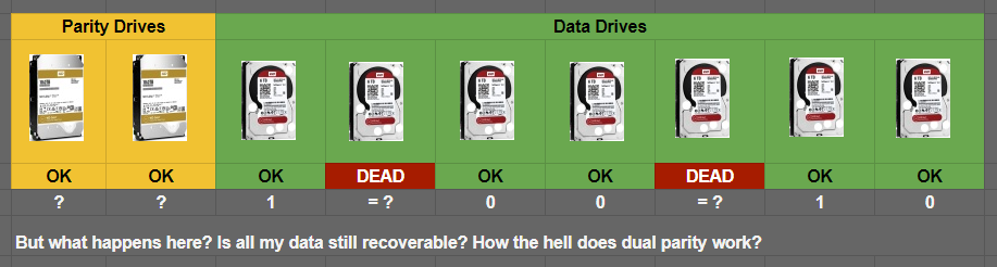

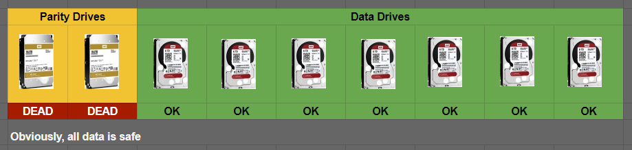

I am still kinda confused, how does dual parity work. Does it really mean, that having unRAID use dual parity I could recover from ANY 2 drives failing?
Like they say, a picture is worth a thousand words...
Edited by shEiD

  • @itimpi Methingks, maybe I just phrased it wrong. I do understand, that parity does not store any regular data, but recovery stuff. And I understand about the math of how many drives can be restored.
Yes
@johnnie.black thanks for the answer.
So what black magic is stored on those 2 parity drives? Any links where I could read up on that?
I mean how does only 2 drives store the info on whats in 28 drives?
