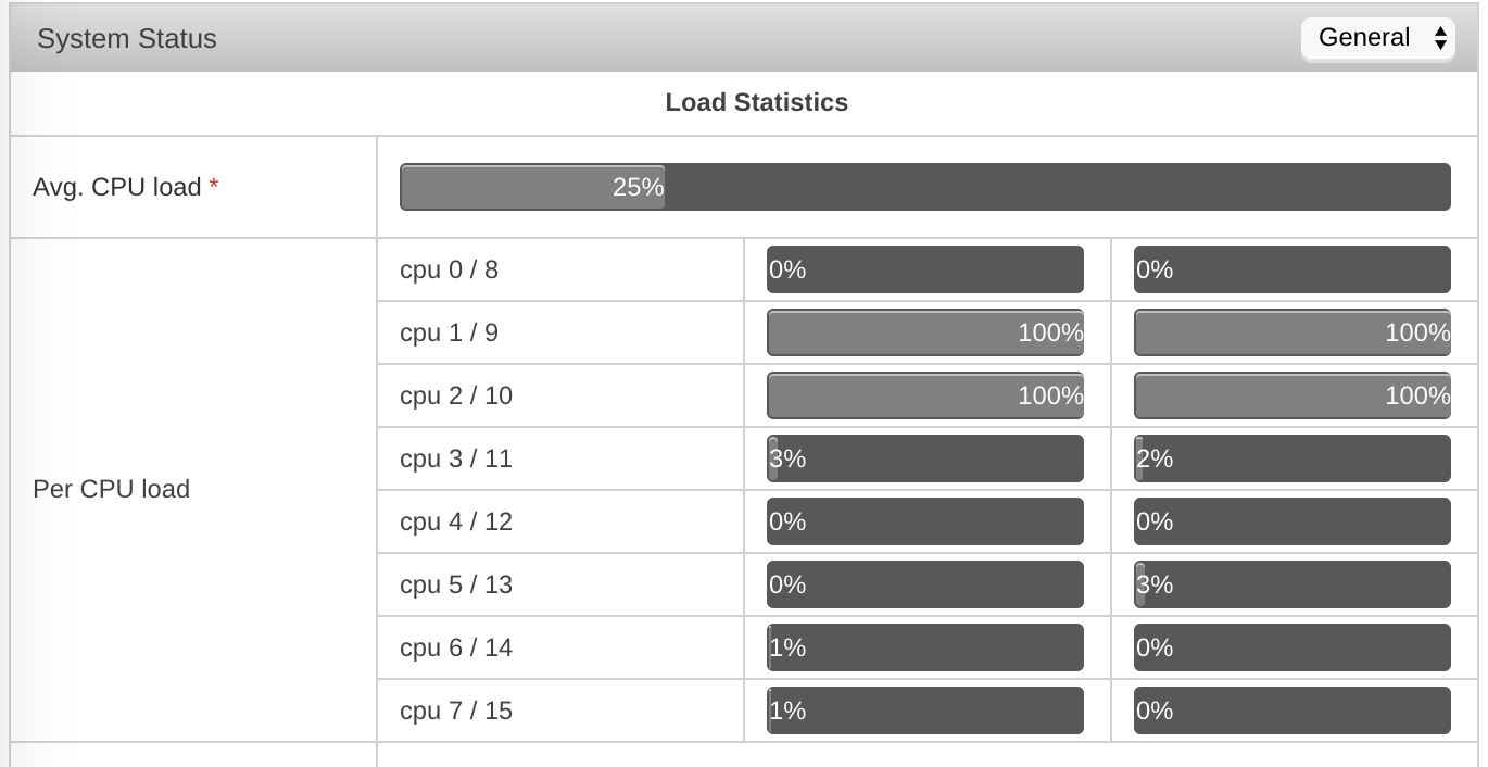

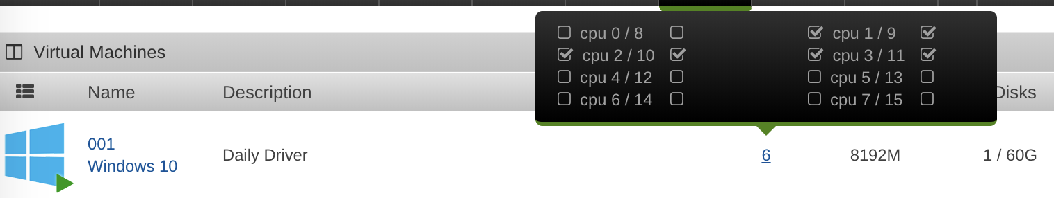

February 18, 20188 yr Hey - had a thought as I was setting up my new 12 core server. My two main sources of CPU stress come from my Plex Docker and from my WIndows VM. And when one is working hardest, normally the other is pretty quiet. So I prefer not to limit cores which allows the task needing the cores to have them all available. From prior experience, if I let them share all their cores, I have issues with the Windows VM slowing while heavy transcoding is happening in Plex. To address, I had excluded the VM's first core from Plex, and that helped a lot, but VM still a bit sluggish. (This was on my old 4 core server that I experimented with this). Holding back a full core from Plex was sort of a big deal though, but couldn't be avoided because otherwise the VM was unusable. But as I was thinking, seems both are using cores in the same order. What if I could let Plex continue to use cores from lowest core up, but let the VM use cores from last core down, as shown below: Default: Plex: 0, 2, 3, 4, 5, 6, 7, 8, 9, 10, 11 VM: 1, 2, 3, 4, 5, 6, 7, 8, 9, 10, 11 New: Plex: 0, 1, 2, 3, 4, 5, 6, 7, 8, 9, 10 VM: 11, 10, 9, 8, 7, 6, 5, 4, 3, 2, 1 They should interfere with each other less. I still have the first core used by each excluded from the other, at least for now. Hoping that will mean less interference in general. But not 100% sure. The nature of Plex may be to transcode using all available cores uniformly, but this can't hurt I don't think. Have not done much transcoding yet, but think this might be worth trying to allow cores to be shared most effectively. Btw - the core mappings have to be manually editted in the XML, from: <vcpupin vcpu='0' cpuset='1'/> <vcpupin vcpu='1' cpuset='13'/> <vcpupin vcpu='2' cpuset='2'/> <vcpupin vcpu='3' cpuset='14'/> <vcpupin vcpu='4' cpuset='3'/> <vcpupin vcpu='5' cpuset='15'/> etc. to: <vcpupin vcpu='0' cpuset='11'/> <vcpupin vcpu='1' cpuset='23'/> <vcpupin vcpu='2' cpuset='10'/> <vcpupin vcpu='3' cpuset='22'/> <vcpupin vcpu='4' cpuset='9'/> <vcpupin vcpu='5' cpuset='21'/> etc. Apologies if this is covered in the video. I didn't go back and rewatch but don't remember seeing it.
February 18, 20188 yr 48 minutes ago, SSD said: Hey - had a thought as I was setting up my new 12 core server. My two main sources of CPU stress come from my Plex Docker and from my WIndows VM. And when one is working hardest, normally the other is pretty quiet. So I prefer not to limit cores which allows the task needing the cores to have them all available. From prior experience, if I let them share all their cores, I have issues with the Windows VM slowing while heavy transcoding is happening in Plex. To address, I had excluded the VM's first core from Plex, and that helped a lot, but VM still a bit sluggish. (This was on my old 4 core server that I experimented with this). Holding back a full core from Plex was sort of a big deal though, but couldn't be avoided because otherwise the VM was unusable. But as I was thinking, seems both are using cores in the same order. What if I could let Plex continue to use cores from lowest core up, but let the VM use cores from last core down, as shown below: Default: Plex: 0, 2, 3, 4, 5, 6, 7, 8, 9, 10, 11 VM: 1, 2, 3, 4, 5, 6, 7, 8, 9, 10, 11 New: Plex: 0, 1, 2, 3, 4, 5, 6, 7, 8, 9, 10 VM: 11, 10, 9, 8, 7, 6, 5, 4, 3, 2, 1 They should interfere with each other less. I still have the first core used by each excluded from the other, at least for now. Hoping that will mean less interference in general. But not 100% sure. The nature of Plex may be to transcode using all available cores uniformly, but this can't hurt I don't think. Have not done much transcoding yet, but think this might be worth trying to allow cores to be shared most effectively. Btw - the core mappings have to be manually editted in the XML, from: <vcpupin vcpu='0' cpuset='1'/> <vcpupin vcpu='1' cpuset='13'/> <vcpupin vcpu='2' cpuset='2'/> <vcpupin vcpu='3' cpuset='14'/> <vcpupin vcpu='4' cpuset='3'/> <vcpupin vcpu='5' cpuset='15'/> etc. to: <vcpupin vcpu='0' cpuset='11'/> <vcpupin vcpu='1' cpuset='23'/> <vcpupin vcpu='2' cpuset='10'/> <vcpupin vcpu='3' cpuset='22'/> <vcpupin vcpu='4' cpuset='9'/> <vcpupin vcpu='5' cpuset='21'/> etc. Apologies if this is covered in the video. I didn't go back and rewatch but don't remember seeing it. I kind of do this with my VMs - my kids VMs are on the lower cores, and mine and the pfsense VM are on the highest cores. I don't know if it helps, but when I'm bored and watching the cores activity the higher cores do seem to get less use.

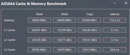

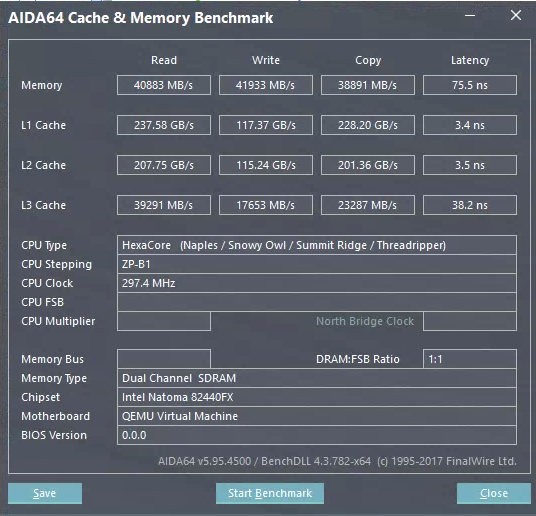

March 16, 20188 yr I have had a great time setting up my UnRaid server and going through all your videos Gridrunner, they have made the setup and tweaking process a joy All tips work great for me except ISOLCPUS which dramatically reduced performance in my case (by dropping 1 core it seems). Has anyone seen this before? I have three cores and 6 threads pinned to my gaming VM which gives good benchmarks in aida64. When I put ISOLCPUs on, the score plummeted by 30-50% and only used two cores while running the test (before it used all three it had pinned). This is a Threadripper system so it has two memory controllers and other semi exotic features. Perhaps the memory score is going down because it's losing access to a core (less access to memory), which is born out by the CPU usage I'm seeing also. But why ISOLCPUS loses me a core, I do not know. This gives a aida64 cache and memory result of: Now, with those CPUS isolated as follows: Quote label unRAID OS menu default kernel /bzimage append isolcpus=1-3,9-11 initrd=/bzroot I get this: and a peak at system status while it's running show that only 2 cores are being used. The same test without ISOLCPUS used all 3 of the cores and gained a better score. Any thoughts? On 16/01/2018 at 11:24 PM, NotYetRated said: Awesome videos, hoping tips here will help me with my 2 VM's experiencing audio/video desync as well as random audio static type issues I have been experiencing. Sorry if I missed this, but how are people checking latency on their VM's? I also would like to know what test others are running here, it's not clear to me if there's any popular testing tools that this forum generally uses.
