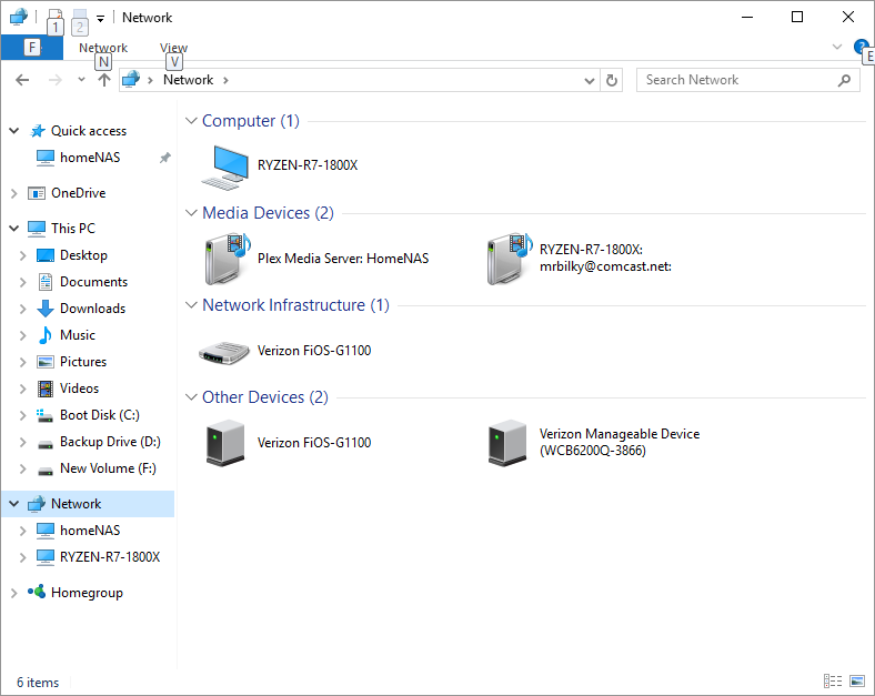

Still perplexed at this issue, so I was able to install the NAS onto my computer manually here's the strange part file explorer does not see it on my network but if I hit start, run and type in the network name bingo it shows up in the network list but once I closse the window and reopen its no longer there and I have to repeat. I did however pin it to quick launch so I guess in some ways that may be a better option, just strange and to compound the issue I was betting on it being me not knowing some network option needed to be enabled on my daily driver an R7 1800x but I fired up my R5 1600x and it too cannot see the NAS on my network so someday I'll stumble upon some setting involving my router/extender and poof it will just appear!

Might be one of these three possibilities that have happened to me to produce the same problem
  1. What has happened to me when my master browser is off line.  If this is true for you then make sure you only have a single master browser on the network at a time and I would try to make sure it is the unRAID server.
  2. What has happened to me when my DHCP server is off line (my router) due to no signal from my cable company.  The router gets confused and no longer provides routes to other computers when it can't see a connection to the outside.
  3. What has happened to me when I don't have network discovery turned on.  You might check to see if it is on for you Google it if you can't remember how to turn it on (like me I always turn it on when I first open explorer).
That's all I've got.
