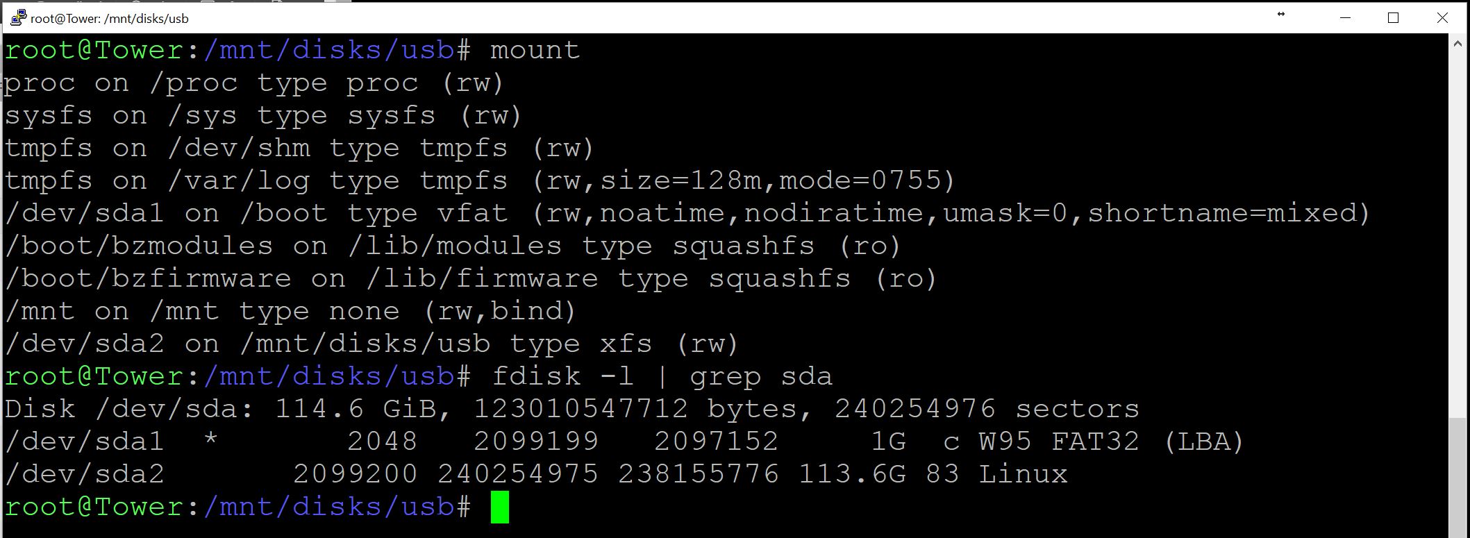

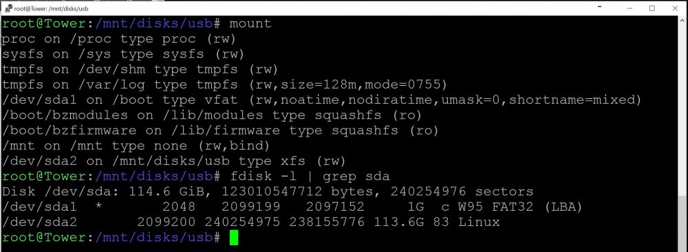

I'm trying the suggestion proposed of using a second partition:
From my earlier screenshot:
128GB USB Flash Drive (/dev/sda)
Partition 1: 1GB FAT32 for UNRAID (sda1) /boot
Partition 2: 127GB XFS for Docker or whatever (sda2) /mnt/disks/usb
In the GUI I'm not able to see partition 2 after is been mounted. I suspect the Dynamix GUI has protection in place to safeguard to keep all of /dev/sda from accidents and crazies like me.
This means to continue on this insane journey I'll be editing the docker.cfg file to force the path mount for Docker.img ... If the safeguards exist at a lower level than the GUI then that may be the end of the line. Stay tuned to find out.
Research complete. This was a great success! Completely achieved what I set out to research and learn so much more in the process.
