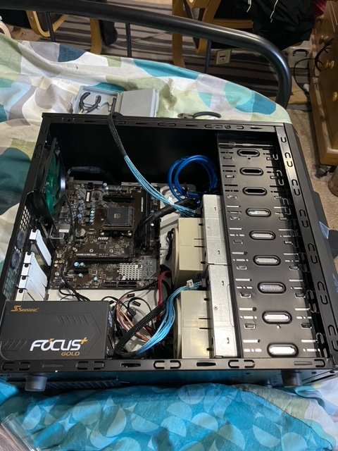

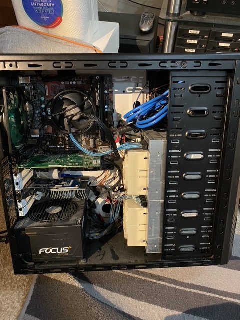

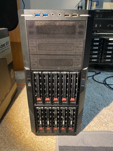

I made the mistake of getting a standard ATX board to use a couple of these cages in a Sharkoon T9 case. As you say, there is an overlap of the cage fans over the end of the motherboard. Made sure I got a much narrower one but it had to be mATX which is no problem (MSI A32M-A PRO Max). It fits and that was all that I was concerned about.
Looking for a third one now. They work great and are super quiet with replacement Nanoxia fans. Never tried them with the original ones.
