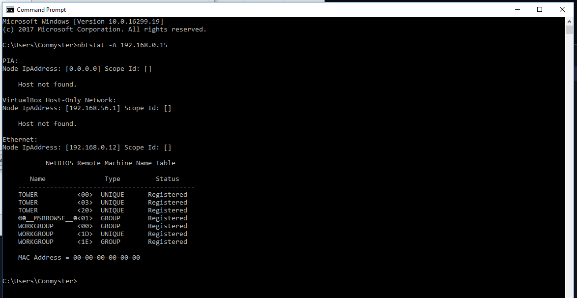

November 7, 20178 yr Hello, I have recently moved house and have got Virgin Media I connected all the Ethernet cables up and expected it to work however it does not I get the following message: What is strange is that over wireless using my iPhone I am able to connect to the server fine and access the shares. Here is the syslog too: syslog.txt Any help will be much appreciated Thanks, Conmyster Edited September 15, 20188 yr by Conmyster
November 7, 20178 yr What is the IP of your unRAID server and what is the IP of the workstation you are trying to connect from? Can you get to the webgui from this windows workstation? Edited November 7, 20178 yr by ashman70
November 7, 20178 yr Author Currently: Sever: 192.168.0.15 PC: 192.168.0.12 I can access the webUI but when I try and connect to it using the network section or even try and map a drive that error message comes up.

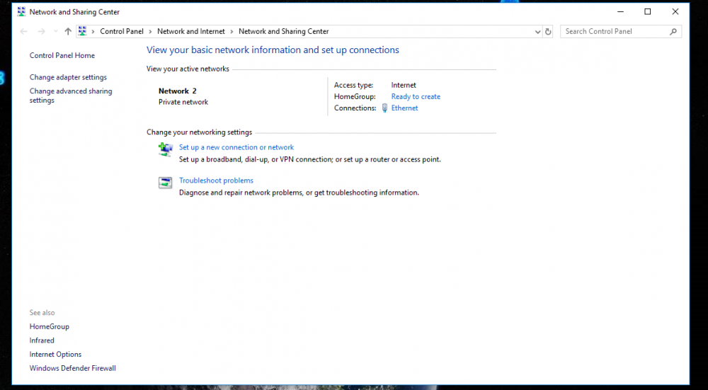

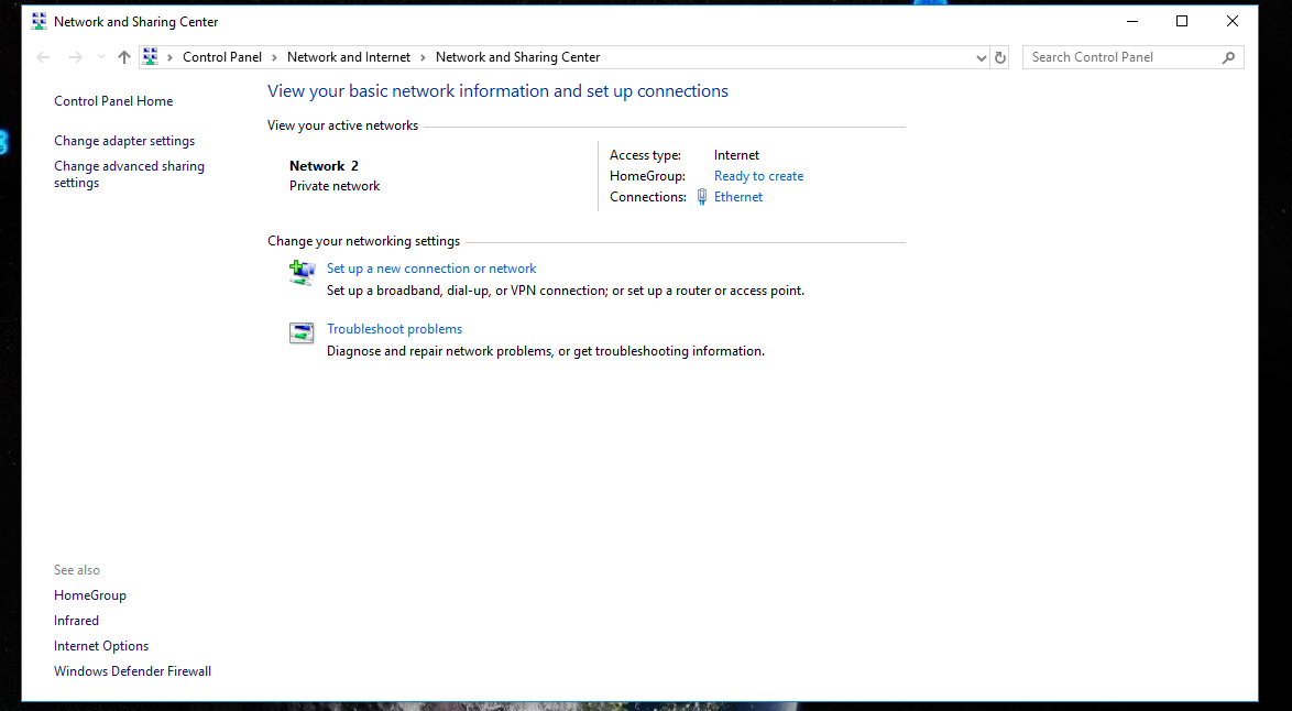

November 7, 20178 yr I suspect your windows box thinks the connection to your new virgin media router is a public network rather then a private network and therefore the windows firewall is blocking the SMB connection to your unraid box.

November 10, 20178 yr Author Well I installed a Windows VM check to see if it could connect and it could so it was defiantly something off with my PC reinstalled the OS and now it’s working.
