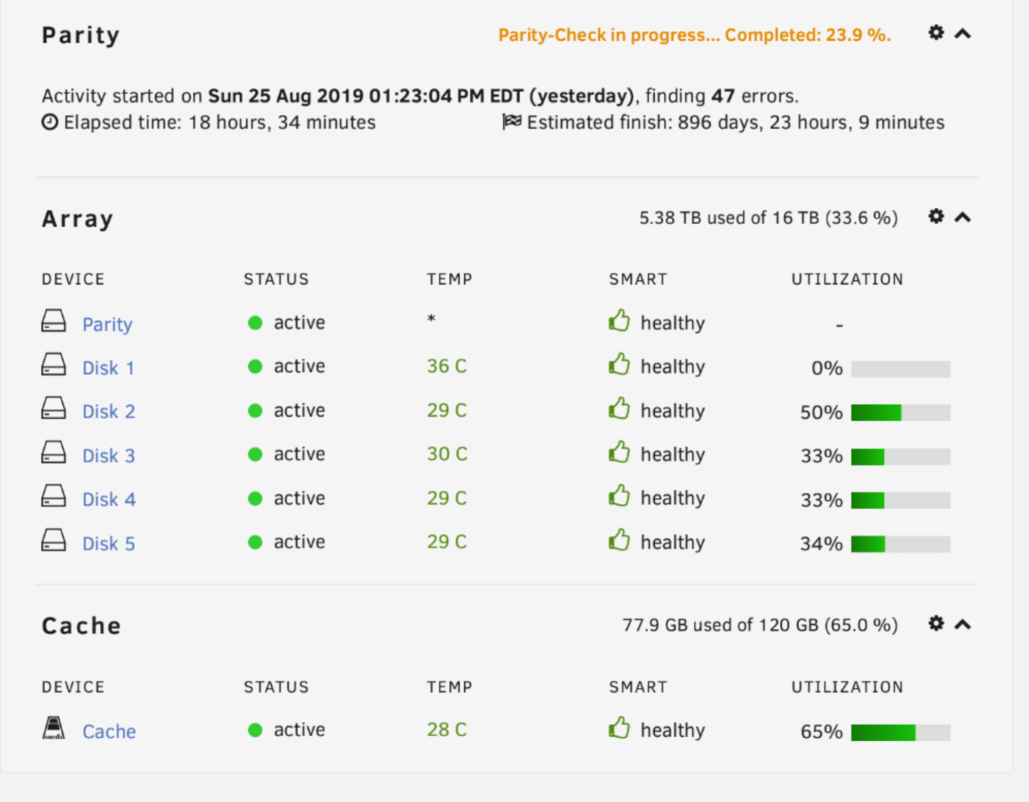

The parity rebuild has been increasing in time, from 20 days, to 190 days, to now over 900 days. Would it make sense for me to format and redo parity fro scratch? The parity disk was brand new for this server build 2 weeks ago.
It appears that without docker containers and VM services running (and in safe mode) the server is stable for now.
Would you agree that this isn't a hardware issue per-se, but rather misconfigured software (somehow /somewhere)?

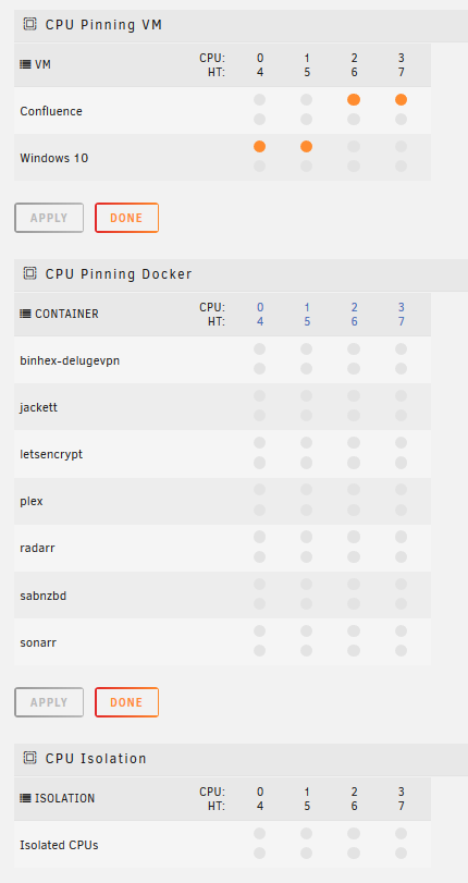

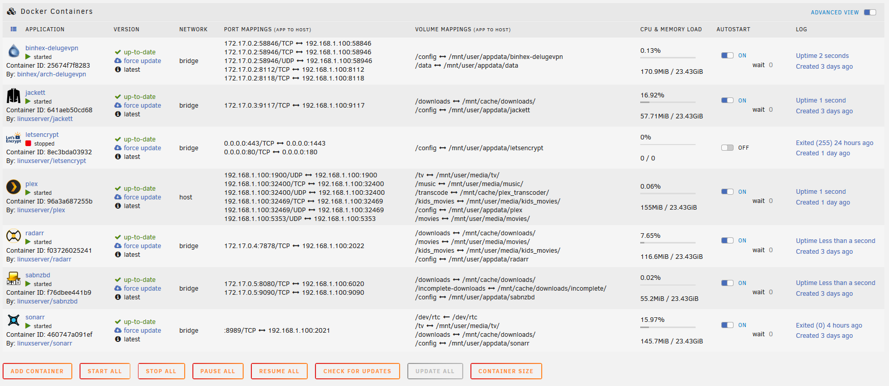

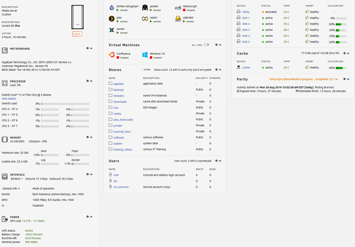

Nothing really stands out in those screenshots. Just try to complete a parity check without any dockers, VMs, or other addons, and making the setting change johnnie.black recommended. No point in digging into all that other stuff if it won't even do that much.

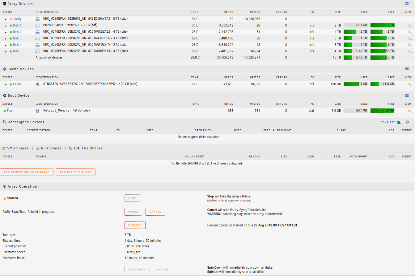

So far a 6TB parity drive sync has taken approx 2 days to complete and still isn't close to being finished.
At 11:30pm last night it shows 93%, 1 hour to complete (approx.)
This morning it shows 93% and a day left to complete (the transfer rate went down from 100MB/s to about 5MB/s)
from 8am this morning to now, it has moved 3% (give or take)
Edited by 905jay
I am looking at the screen capture that you provided in the post above.  What is surprising to me if that all of the data disks are still spun up when the parity check is 96.8% complete.  Looking at the writes, the only disk that has any substantial number of writes is disk5.  disk4 appears to have substantially more reads than the equivalent size disk3.  I would conclude that something is carrying on some type of disk operations on both disk4 and disk5 and probably while the parity check is running.  Plus, by this point the only thing the parity check is doing is verifying that the parity disk can be read...
Disk activity during the parity check will cause the check to run more slowly but this seems to be a lot more than would be expected.  There are a few other threads floating around (including one bug report) about file speed issues.  @905jay, do check and see if you can figure out what is causing those extra reads and writes.  I would suspect it is something that is happening in the background as you are only complaining about the speed of the parity check at this point.  That is the 'why' for the questions about the mover.  The mover was added to Unraid so that it could move the files off of the cache drive in the middle of the night so that it would not affected normal disk access speeds.  Most folks have it setup to run once a day or once a week-- not once an hour.
