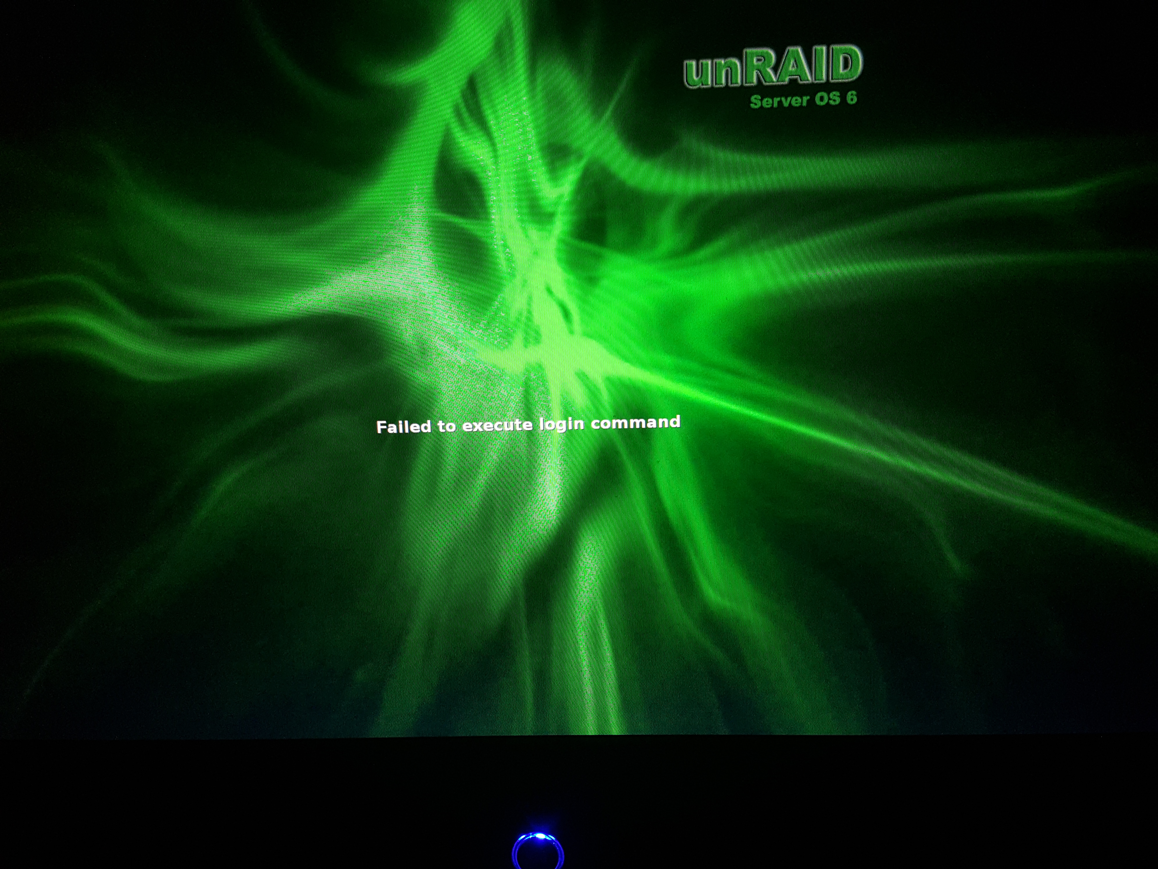

New one for me. Went to login and I kept getting this error. Any ideas or suggestions? OS 6
1---  Try a reboot
2--- Pull the flash drive and run chkdsk on it.
Forgot to mention that I am attempting to login directly on the unraid server. My remote client is no longer able to login. I will need to do complete troubleshooting to ensure it's not a network issue as well. Attach the screenshot of the GUI screen. The non-GUI screen does not produce an error message but is stuck in a login loop. I did power cycle it last night, with the same result. I will pull the SSD later today and run chkdsk.

UPDATE: It was a user error. I was trying to login to a user account that didn't have a password, whereas I normally login as root. Sorry for any confusion.
FURTHER UPDATE: Try logging in as root and change the User Accounts/Profiles, if need be? It might be a user error... like me. =D

I am having the same problem. I can only login as root. If I use the only other User that I created I get the "failed to execute login command". I checked the flash drive and it reports as OK. I deleted and re-created the User account, but the same message appears when trying to login.
Only root user has access to the webUI or the command line. The other users are only for network share access.
Should one change the name of the root user, or just leave it as root with a strong password?
You can't change the name of the root user. And your server shouldn't be accessible outside your local network regardless of how strong the password is.
