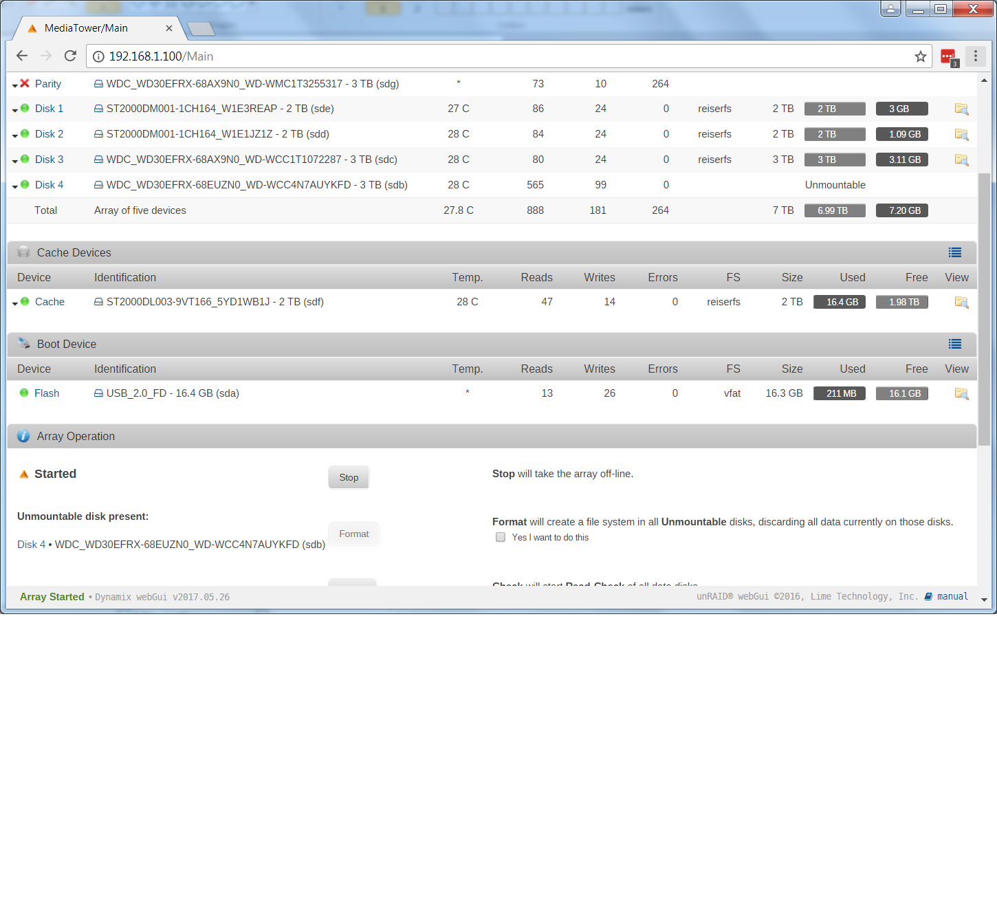

HELP!! I replaced the drive with the new drive. Assigned it to Disk 4. But the array now started with the following (see attached image and log files). I can't access any of my emulated data as well! Attaching logs here as well.

Most likely you upset the connection on parity while replacing disk4.
I don't understand why it would try to write and then disable parity while rebuilding disk4, but that does seem to be what syslog is saying.

Parity disk dropped offline since the beginning of the rebuild, possibly because of a bad cable, ideally you should have stopped the rebuild when you got the errors, since the rebuilt disk is completely corrupt, but if parity disk is OK we can force a new rebuild with the invalid slot command, first thing to do is to disable array autostart (if enable) power down, check/replace parity cables, power back on, and post new diags.

That's normal behavior, if there are read errors on another disk during a rebuild unRAID logs "multiple disk errors", i.e., there are errors on more disks than parity can recover, it will continue the rebuild but there will be corruption, in this case the complete disk is corrupt since parity dropped immediately offline, but on cases where there are only a few read errors the rebuilt disk will be mostly OK, which can be better then nothing.
