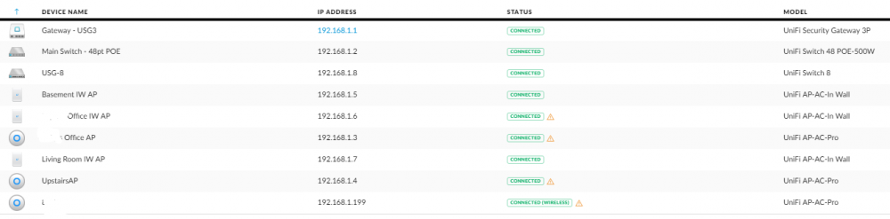

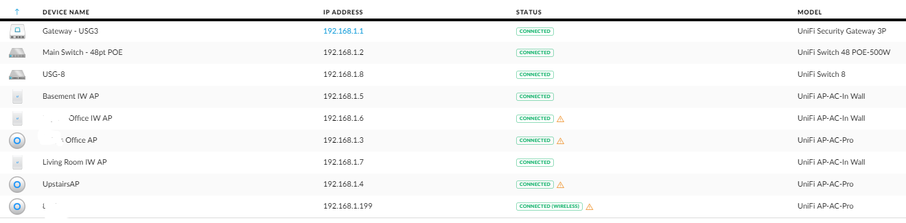

May 17, 20188 yr Nice, sounds like you got it figured out. I will leave this here for anyone else that comes across the thread. The Ubiquiti gear is a little more expensive, but it's far better than the consumer grade stuff and MUCH cheaper than enterprise level. I have a storage room full of Cisco and HP hardware that I've used in the past, which worked great, but I've converted everything over to Ubiquiti. Much easier to manage. The features you get for the money make it a good value IMO, but it's all about what YOU value and what you are trying to do. I have a site to site VPN to a family member, 3 VLAN's, a bunch of AP's (one AP that is running in mesh), and a site to site VPN to Azure. All relatively easy to set up. I will add that you get live chat with techs that will log in remotely to help you with configuration/troubleshooting, and it doesn't require a support contract. The in-wall AP's are the coolest thing since sliced bread. Great coverage, they look good, and very versatile. I've replaced 2 of the UAP-AC-PRO's with a few IW-AP's.
